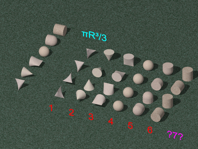

More than the classical cone/sphere/cylinder used to count 1,2,3.
Counting from 1 to 6, here a set of increasing volumes.
Constraint are:
 * Volume must be inside a box of size 2R
 * Each side of the box must be touched, at least by a point, even on border
there such simple solid ? And what does it looks like ?
Solids are:
 1. Milk carton (berlingot) quartic
 2. Cone
 3. conocuneus (coin conique) quartic
 4. Sphere
 5. spherical top on cylinder
 6. Cylinder
Download 'volume.jpg' (289 KB)
Preview of image 'volume.jpg'

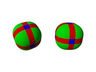

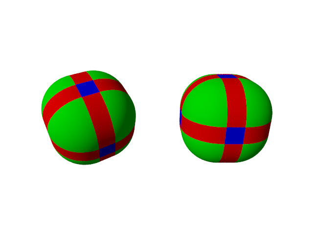

Here is a crazy superellipsoid shape which fits the bill of 7*pi/3. Although I
do have a mathematical formula which gives an exact multiple it is very nasty
so I am not sure if this counts under your brief for the shape. I have mainly
constructed this as a point of interest that such a shape can be found and
built easily with pov csg. I am still hoping I can find a simpler shape which
wouldn't have required quite so much work to build.
Malcolm
Download 'mad shape.jpg' (56 KB)
Preview of image 'mad shape.jpg'

Le 15.01.2009 22:48, milco2006 nous fit lire :
Can you explain a bit how, I fail to understand it's construction.
Is there some ratio from green to blue/red ?
> Although I
I have nothing against a superellipsoid, as long as you provide its
parameters (and hopefully they are some kind of 'nice', even a cubic
root of a fraction might match), and by the same way demonstrate that
the volume is exactly and mathematicaly 7pi/3.
(and not an approximate value close enough)
Which seems a bit complex to perform, given that the sole formula of
volume that I found on mathworld for the superellipsoid is based on the
Gamma function, which is far from simplying to 7pi/3 at some stage.
(Just prove me wrong... I have no doubt that one superellipsoid, or even
a whole family of them, can have the right volume... but the real answer
 need to identify which ones!)
