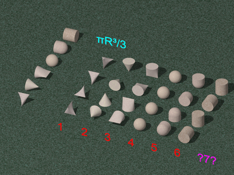

More than the classical cone/sphere/cylinder used to count 1,2,3.
Counting from 1 to 6, here a set of increasing volumes.
Constraint are:
 * Volume must be inside a box of size 2R
 * Each side of the box must be touched, at least by a point, even on border
there such simple solid ? And what does it looks like ?
Solids are:
 1. Milk carton (berlingot) quartic
 2. Cone
 3. conocuneus (coin conique) quartic
 4. Sphere
 5. spherical top on cylinder
 6. Cylinder
Download 'volume.jpg' (289 KB)
Preview of image 'volume.jpg'

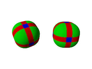

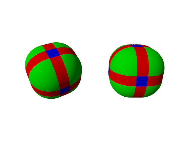

Here is a crazy superellipsoid shape which fits the bill of 7*pi/3. Although I
do have a mathematical formula which gives an exact multiple it is very nasty
so I am not sure if this counts under your brief for the shape. I have mainly
constructed this as a point of interest that such a shape can be found and
built easily with pov csg. I am still hoping I can find a simpler shape which
wouldn't have required quite so much work to build.
Malcolm
Download 'mad shape.jpg' (56 KB)
Preview of image 'mad shape.jpg'

Le 15.01.2009 22:48, milco2006 nous fit lire :
Can you explain a bit how, I fail to understand it's construction.
Is there some ratio from green to blue/red ?
> Although I
I have nothing against a superellipsoid, as long as you provide its
parameters (and hopefully they are some kind of 'nice', even a cubic
root of a fraction might match), and by the same way demonstrate that
the volume is exactly and mathematicaly 7pi/3.
(and not an approximate value close enough)
Which seems a bit complex to perform, given that the sole formula of
volume that I found on mathworld for the superellipsoid is based on the
Gamma function, which is far from simplying to 7pi/3 at some stage.
(Just prove me wrong... I have no doubt that one superellipsoid, or even
a whole family of them, can have the right volume... but the real answer
 need to identify which ones!)

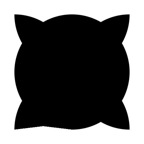

From: clipka
Subject: Re: 6 volumes
Date: 16 Jan 2009 15:05:00
Message: <web.4970e74b1026618d94bbb57b0@news.povray.org>
Le_Forgeron <jgr### [at] freefr> wrote:
> > Note that in the spirit of the puzzle, a prism would do... if only you
> That does not make it easier.
If a certain minimum of beauty is *not* a prerequisite, then I have something:
Make a prism of this...
The "ears" are constructed with the same radius as the "body" of the shape; the
triangular cutout at the bottom left must have a height of R*(7*sqrt(3/4)-6)
(which *can* be done with compass & straightline).
The fact that the total area of this shape is 7*R^2*pi/6 should be evident... ;)
Download '7.png' (17 KB)
Preview of image '7.png'
From: Le Forgeron
Date: 17 Jan 2009 04:34:19
Message: <4971a61b$1@news.povray.org>
Le 16.01.2009 21:00, clipka nous fit lire :
Ok... you are better than me... a miminum of beauty should be a
requisite. Definitively.
Any 'nice' base for such prism ?
Or a thought on another shape ?
