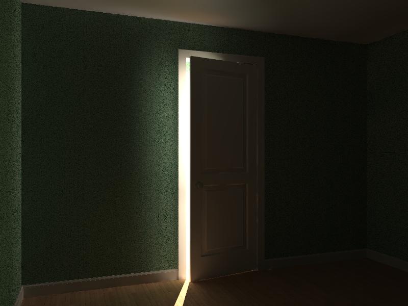

After reading a message by Warp about how save_file and load_file could work
on the same scene together, I remembered that he mentioned this before. Back
then I had the intention to test it, but surely RL came in the way... now, I
don't have much free time these days anyhow, but I've not resisted to try
it, because I had a "bengenesque" idea that might work: use the animation
feature to successively decrease the error_bound while saving the data and
reloading it on the next frame:
#declare this_fr=concat("saved-",str(frame_number,2,0),".rad");
#declare last_fr=concat("saved-",str(frame_number-1,2,0),".rad");
radiosity {
   count 160
   error_bound 0.04+0.02*frame_number
   nearest_count 10
   recursion_limit rad_bounces
   brightness rad_brightness
   #if (file_exists(last_fr)=1)
    load_file last_fr
    always_sample off
   #end
   save_file this_fr
   randomize on

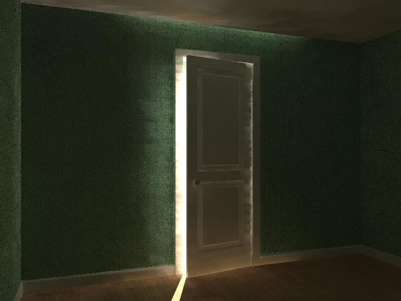

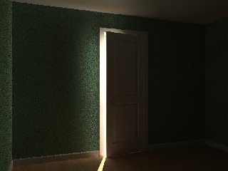

Running 16 frames I get a very good result in just 1 hour: see
secret-progressive16.jpg. I also included for reference the first pic of the
sequence (secret-progressive01.jpg), and also a pic showing how the end
settings will look without loading the previous frames radiosity
(secret-progressive16b.jpg).
I think it deserves some more research, but looks promising to overcome
many radiosity problems.
Jaime
Download 'secret-progressive16.jpg' (35 KB) Download 'secret-progressive01.jpg' (39 KB) Download 'secret-progressive16b.jpg' (47 KB)
Preview of image 'secret-progressive16.jpg'
Preview of image 'secret-progressive01.jpg'
Preview of image 'secret-progressive16b.jpg'

Things to note:
- By setting nearest_count to 10, no additional samples will be taken after the
10th pass whatsoever. In fact, many samples will have been taken much earlier.
- By taking high error_bound samples first, which are low quality, you will
reduce the number of low error_bound samples taken.
- The artifacts you see in the 16b image are not due to the quality of the
radiosity samples used for that shot, but due to the moment they were taken:
What we see are the results of final-trace sampling, with the new samples
affecting their surroundings only in successive rows.
I expect that exactly the same quality - if not even better - can be achieved
within just two frames by using constant settings as currently used in the...
hm, let me guesstimate... something like the 6th frame.
You may also want to try using 1/max(image_width,image_height) as pretrace_end,
and N/max(image_width,image_height) with N being some power of 2 as
pretrace_start, and render just a single frame. Try a nearest_count of 3 or the
like.
Finally, expect 3.7 radiosity to become better anyway.
Oh, and finally finally - keep having ideas like these, 'cause even if they
don't work as you may think they may still be inspiring. And inspiration is the
thing most needed with POV's radiosity.
> after the 10th pass whatsoever. In fact, many samples will have been
> taken much earlier.
   I should have warned that "I really don't know what I'm doing" is my
second name... but thanks for the pointer.
> will reduce the number of low error_bound samples taken.
   Well, here I must admit that I thought I knew what I was doing... ;) What
I wanted was to take first the high error_bound samples, to avoid the
problem of radiosity coming trough the joints... but perhaps it works
equally the other way: I must try it.
> the radiosity samples used for that shot, but due to the moment they were
> taken: What we see are the results of final-trace sampling, with the new
> samples affecting their surroundings only in successive rows.
   I think I didn't fully understand this explanation... sorry (not your
fault). But the 16b was done apart in one pass, without loading any radiosity...
> achieved within just two frames by using constant settings as currently
> used in the... hm, let me guesstimate... something like the 6th frame.
> pretrace_end, and N/max(image_width,image_height) with N being some power
> of 2 as pretrace_start, and render just a single frame. Try a
> nearest_count of 3 or the like.
   Again, I must try these tips...
   I hope so!
> they don't work as you may think they may still be inspiring. And
> inspiration is the thing most needed with POV's radiosity.
   Thanks: I have lots of weird ideas... and not only abut radiosity, but
many show to be nonsense after the first tests.
  For example, I also tried something similar to what Holger Karsten tried
with MCPov: rendering many frames with random sample sequences (MegaPOV) and
then averaging them with ImageMagick. It sort of works, but needs too many
frames to get ride of the noise.
   Now, if someone is interested, I had the strange idea that a
fade_distance  for reflections will help making blurred reflections with
averaged normals... but I'm unable to test on my head if it will work.
Jaime
If you're talking about that light leaking though walls and the like, that's
actually the high error_bound samples, not the low ones.
If you're talking about light leaking through at the hinge side of the door,
that may even be physically correct.
I'll try again, just the basics:
One of the main source of artifacts are radiosity samples which are taken during
the final render. The artifacts seen in the 16b sample look exactly like that
type.
(I'll not go into detail *why* they look that way ;) it's simply a side effect
of final-render-sampling that cannot be avoided)
This happens when the pretrace steps didn't generate enough samples.
If the same samples would be available at the start of the final render already,
you would not get any such artifacts.
They are available *after* that final render, and this is the moment when
radiosity data saving is done. So if you render the whole smash all over again,
this time loading the samples from the previous run, you don't get a different
set of samples - but you get a much better render.
