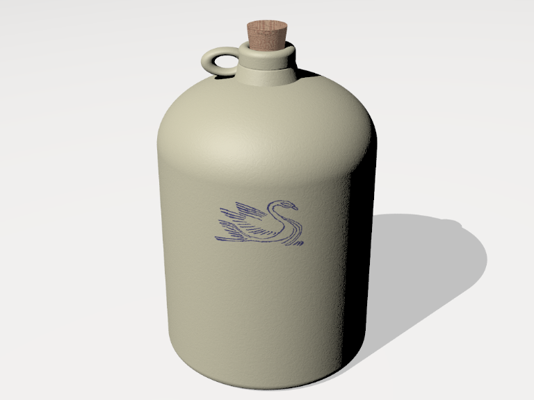

Howdy,
I'm working on some objects for a scene that have maker marks or
decorations. The swan on this jug is from a photograph of an actual jug in
my shop. I used Gimp to play with the color map. I saved the gif image with
indexed color map, then I was able to use several transmit statements in my
image_map statement to isolate the background and image. Before all this I
had developed a texture_map that has some age marks (dents), but when I
tried to overlay the swan texture onto the crock texture I ran into a
problem (can't overlay a texture over a patterned texture). I was however
able to at least get it this far when I removed the dents portion of my
texture map. Now my jug looks rather sterile and I'd like to age it up a
bit. Any ideas on how to do this?
Jim
Download 'work.png' (213 KB)
Preview of image 'work.png'

It should be possible to do this in a layered texture. See for instance the
following example from one of my textures where I added an image_map as the
uppermost texture layer:

If you use a gif as image_map, it should be rather easy to make all colors
have tranmit 1, except for the swan color which would get transmit 0.
Hope this helps.
From: Jim Holsenback
Subject: Re: Crockery Jug
Date: 20 Sep 2008 10:50:38
Message: <48d50dbe@news.povray.org>
"Thomas de Groot" <t.d### [at] internlDOTnet> wrote in message
news:48d503c5$1@news.povray.org...
> the following example from one of my textures where I added an image_map
> as the uppermost texture layer:
Bingo! ..... I see where I wandered off the path. Thanks Thomas!
Jim

Now that you can place textures how you want them, you can always try my
proximity pattern macros
(news://news.povray.org:119/489f4610@news.povray.org) to get some dirt
into the inside edges. I'd like to see how it turns out :)
Sam

Why bothering using several transparency statements in am image_map? You can set
your GIF to have one, or several color, as transparent. That way, you can make
the background disapear.
Or, you could have used a PNG with an alpha channel, and have antialiased
transparency.

this was something new to me so maybe my work flow needs a look still. I
ended up with a color_map with 16 colors. Some of thhe colors were gradients
of blue (transition between the blue swan outline and the background). I
made all the transition colors all blue or all white. Then ended up with the
texture statement looking like this:
texture {
      pigment {
      image_map {
        gif "Swan.gif"
        transmit 11,1.0
        transmit 12,1.0
        transmit 13 1.0
        transmit 14,1.0
        transmit 15,1.0
        once
      scale <0.05,0.25,0.05>
      scale 3
      warp {cylindrical}
      translate y*1.4
      rotate y*300
maybe not the most elegant but it worked for what I wanted.
>> > Sam
>> ooooo good idea .... i'll have a look :-)
>> Jim
> If all else fails, function patterns can do almost anything...
Image pattern is a good choice as well :-)
Marc
