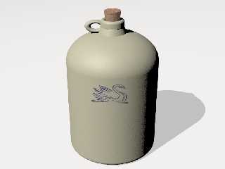

Howdy,
I'm working on some objects for a scene that have maker marks or
decorations. The swan on this jug is from a photograph of an actual jug in
my shop. I used Gimp to play with the color map. I saved the gif image with
indexed color map, then I was able to use several transmit statements in my
image_map statement to isolate the background and image. Before all this I
had developed a texture_map that has some age marks (dents), but when I
tried to overlay the swan texture onto the crock texture I ran into a
problem (can't overlay a texture over a patterned texture). I was however
able to at least get it this far when I removed the dents portion of my
texture map. Now my jug looks rather sterile and I'd like to age it up a
bit. Any ideas on how to do this?
Jim
Download 'work.png' (213 KB)
Preview of image 'work.png'

It should be possible to do this in a layered texture. See for instance the
following example from one of my textures where I added an image_map as the
uppermost texture layer:
//=====start code====
#declare StoneWall =
texture { // BrickUnderlayer
  pigment {
    brick
    pigment { // Mortar
      granite
      color_map {
        [ 0.0 rgbft <0.3854, 0.3854, 0.3854, 0.0, 0.0> ]
        [ 1.0 rgbft <0.593733, 0.593733, 0.593733, 0.0, 0.0> ]
    pigment { // Brick
      granite
      color_map {
        [ 0.0      rgbft <0.291667, 0.0, 0.0, 0.0, 0.0> ]
        [ 0.355872 rgbft <0.6979, 0.552067, 0.239567, 0.0, 0.0> ]
        [ 1.0      rgbft <1.0, 1.0, 0.7604, 0.0, 0.0> ]
      scale  0.1
    brick_size <2.0, 0.5, 2.0>
    mortar 0.05
    warp {
      turbulence <0.06, 0.06, 0.06>
      octaves 4
  normal {
    brick
    mortar 0.05
    bump_size 1.0
    warp {
      octaves 4
  scale  0.3
  rotate -90.0 * x
  translate <-0.12, 0.15, 0.03>
texture { // PlasterCoating
  pigment {
    crackle solid
    pigment_map {
      [ 0.0   color rgbt <0.0, 0.0, 0.0, 1.0> ]
      [ 0.35  color rgbt <0.0, 0.0, 0.0, 1.0> ]
      [ 0.35  granite
              color_map {
                [ 0.0  rgbft <0.416667, 0.343733, 0.177067, 0.0, 0.0> ]
                [ 1.0  rgbft <0.763904, 0.666657, 0.444429, 0.0, 0.0> ]
              scale  0.1
      [ 0.65  granite
              color_map {
              scale  0.1
      [ 0.65  granite
              color_map {
                [ 0.0  rgbft <0.4479, 0.364567, 0.2604, 0.0, 0.0> ]
                [ 1.0  rgbft <0.770224, 0.696692, 0.604776, 0.0, 0.0> ]
              scale  0.1
  normal {
    crackle solid
    normal_map {
      [ 0.0 crackle solid //granite , 0.1
            scale  0.1
      [1.0  crackle solid //granite , 0.1
            scale  0.1
    bump_size 1.0
  scale  0.6
texture { // Dirt
  pigment {
    gradient z
    color_map {
      [ 0.0       rgbft <0.25, 0.1979, 0.1979, 0.0, 0.7> ]
      [ 0.281139  rgbft <0.3229, 0.302067, 0.2604, 0.0, 0.9> ]
      [ 1.0       rgbft <1.0, 1.0, 1.0, 0.0, 1.0> ]
    warp {
      turbulence <0.4, 0.2, 0.3>
  scale  <0.2, 0.1, 5.0>
  translate -0.5 * z
texture {
  pigment {
    image_map {
      png "plasma3.png"
      map_type 1   // 0=planar, 1=spherical, 2=cylindrical, 5=torus
      interpolate 2   // 0=none, 1=linear, 2=bilinear, 4=normalized distance
      // once           // for no repetitive tiling
      transmit all 0.7   // N=all or color index # (0...N), V= value
(0.0...1.0)
    }     // image_map
sphere {
  0.0, 1
  texture {StoneWall}
//===end code===
If you use a gif as image_map, it should be rather easy to make all colors
have tranmit 1, except for the swan color which would get transmit 0.
Hope this helps.
From: Jim Holsenback
Subject: Re: Crockery Jug
Date: 20 Sep 2008 10:50:38
Message: <48d50dbe@news.povray.org>
"Thomas de Groot" <t.d### [at] internlDOTnet> wrote in message
news:48d503c5$1@news.povray.org...
> the following example from one of my textures where I added an image_map
> as the uppermost texture layer:
Bingo! ..... I see where I wandered off the path. Thanks Thomas!
Jim

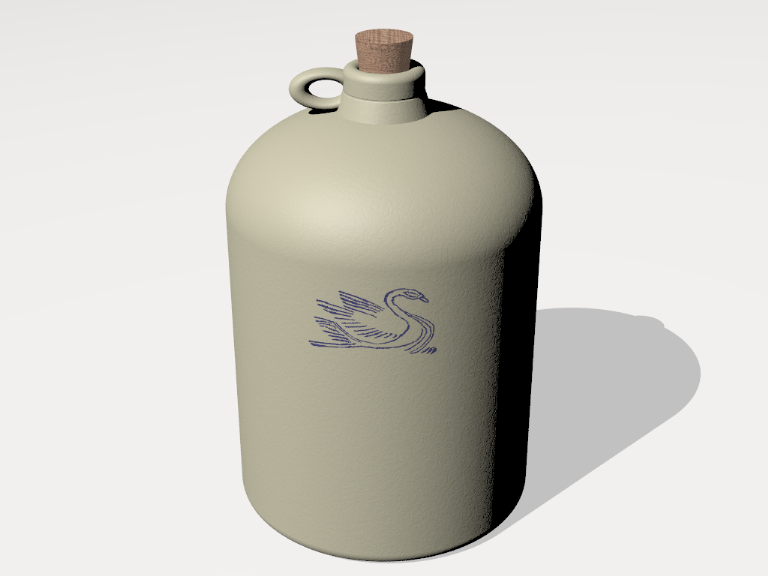

Date: 21 Sep 2008 06:54:54
Message: <48d627fe@news.povray.org>
"Alain" <ele### [at] netscapenet> wrote in message
news:48d56ced$1@news.povray.org...
> Why bothering using several transparency statements in am image_map? You
> can set your GIF to have one, or several color, as transparent. That way,
> you can make the background disapear.
> Or, you could have used a PNG with an alpha channel, and have antialiased
> transparency.
this was something new to me so maybe my work flow needs a look still. I
ended up with a color_map with 16 colors. Some of thhe colors were gradients
of blue (transition between the blue swan outline and the background). I
made all the transition colors all blue or all white. Then ended up with the
texture statement looking like this:
texture {
      pigment {
      image_map {
        gif "Swan.gif"
        transmit 11,1.0
        transmit 12,1.0
        transmit 13 1.0
        transmit 14,1.0
        transmit 15,1.0
        once
      scale <0.05,0.25,0.05>
      scale 3
      warp {cylindrical}
      translate y*1.4
      rotate y*300
maybe not the most elegant but it worked for what I wanted.
Jim
