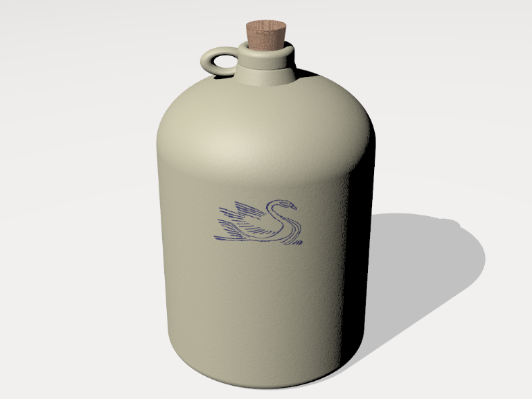

Howdy,
I'm working on some objects for a scene that have maker marks or
decorations. The swan on this jug is from a photograph of an actual jug in
my shop. I used Gimp to play with the color map. I saved the gif image with
indexed color map, then I was able to use several transmit statements in my
image_map statement to isolate the background and image. Before all this I
had developed a texture_map that has some age marks (dents), but when I
tried to overlay the swan texture onto the crock texture I ran into a
problem (can't overlay a texture over a patterned texture). I was however
able to at least get it this far when I removed the dents portion of my
texture map. Now my jug looks rather sterile and I'd like to age it up a
bit. Any ideas on how to do this?
Jim
Download 'work.png' (213 KB)
Preview of image 'work.png'
Subject: Re: Crockery Jug
Date: 20 Sep 2008 10:08:05
Message: <48d503c5$1@news.povray.org>
"Jim Holsenback" <jho### [at] hotmailcom> schreef in bericht
news:48d4e73c@news.povray.org...
> Howdy,
> with indexed color map, then I was able to use several transmit statements
> in my image_map statement to isolate the background and image. Before all
> this I had developed a texture_map that has some age marks (dents), but
> when I tried to overlay the swan texture onto the crock texture I ran into
> a problem (can't overlay a texture over a patterned texture). I was
> however able to at least get it this far when I removed the dents portion
> of my texture map. Now my jug looks rather sterile and I'd like to age it
> up a bit. Any ideas on how to do this?
It should be possible to do this in a layered texture. See for instance the
following example from one of my textures where I added an image_map as the
uppermost texture layer:

If you use a gif as image_map, it should be rather easy to make all colors
have tranmit 1, except for the swan color which would get transmit 0.
Hope this helps.
From: Jim Holsenback
Date: 20 Sep 2008 10:50:38
Message: <48d50dbe@news.povray.org>
"Thomas de Groot" <t.d### [at] internlDOTnet> wrote in message
news:48d503c5$1@news.povray.org...
> the following example from one of my textures where I added an image_map
> as the uppermost texture layer:
Bingo! ..... I see where I wandered off the path. Thanks Thomas!
Jim

Why bothering using several transparency statements in am image_map? You can set
your GIF to have one, or several color, as transparent. That way, you can make
the background disapear.
Or, you could have used a PNG with an alpha channel, and have antialiased
transparency.
Date: 21 Sep 2008 06:54:54
Message: <48d627fe@news.povray.org>
"Alain" <ele### [at] netscapenet> wrote in message
news:48d56ced$1@news.povray.org...
> can set your GIF to have one, or several color, as transparent. That way,
> you can make the background disapear.
> transparency.
this was something new to me so maybe my work flow needs a look still. I
ended up with a color_map with 16 colors. Some of thhe colors were gradients
of blue (transition between the blue swan outline and the background). I
made all the transition colors all blue or all white. Then ended up with the
texture statement looking like this:
texture {
      pigment {
      image_map {
        gif "Swan.gif"
        transmit 11,1.0
        transmit 12,1.0
        transmit 13 1.0
        transmit 14,1.0
        transmit 15,1.0
        once
      scale <0.05,0.25,0.05>
      scale 3
      warp {cylindrical}
      translate y*1.4
      rotate y*300
maybe not the most elegant but it worked for what I wanted.
