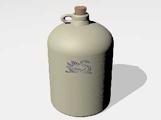

Howdy,
I'm working on some objects for a scene that have maker marks or
decorations. The swan on this jug is from a photograph of an actual jug in
my shop. I used Gimp to play with the color map. I saved the gif image with
indexed color map, then I was able to use several transmit statements in my
image_map statement to isolate the background and image. Before all this I
had developed a texture_map that has some age marks (dents), but when I
tried to overlay the swan texture onto the crock texture I ran into a
problem (can't overlay a texture over a patterned texture). I was however
able to at least get it this far when I removed the dents portion of my
texture map. Now my jug looks rather sterile and I'd like to age it up a
bit. Any ideas on how to do this?
Jim
Download 'work.png' (213 KB)
Preview of image 'work.png'

It should be possible to do this in a layered texture. See for instance the
following example from one of my textures where I added an image_map as the
uppermost texture layer:

If you use a gif as image_map, it should be rather easy to make all colors
have tranmit 1, except for the swan color which would get transmit 0.
Hope this helps.

Bingo! ..... I see where I wandered off the path. Thanks Thomas!

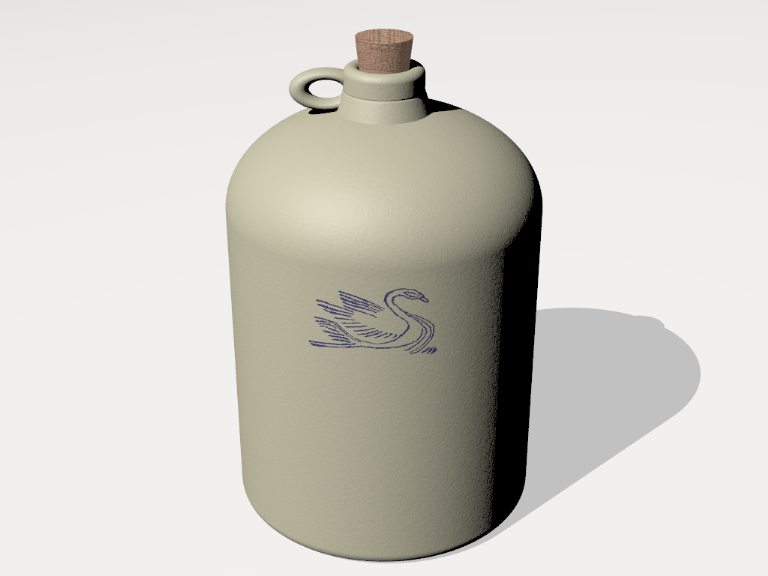

this was something new to me so maybe my work flow needs a look still. I
ended up with a color_map with 16 colors. Some of thhe colors were gradients
of blue (transition between the blue swan outline and the background). I
made all the transition colors all blue or all white. Then ended up with the
texture statement looking like this:
texture {
      pigment {
      image_map {
        gif "Swan.gif"
        transmit 11,1.0
        transmit 12,1.0
        transmit 13 1.0
        transmit 14,1.0
        transmit 15,1.0
        once
      scale <0.05,0.25,0.05>
      scale 3
      warp {cylindrical}
      translate y*1.4
      rotate y*300
maybe not the most elegant but it worked for what I wanted.
