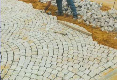

Once in a while I try to solve this puzzle, but I give up. It is beyond my
skills.
How would one model this pavement in POV-Ray? It looks simpler than it is
as - obviously - the inner arc of a row of stones is smaller than the outer
arc. In RL (as on the examples below) this is constantly compensated I
suppose to keep the pattern regular and symmetrical....

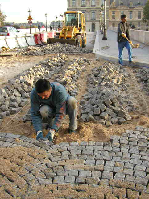

I would think that the key distances of any significance in the sample
picture you posted are the radius of the outer edge of an arc and the centre
to centre distance.  In your image I would think that the stick is used to
keep the outer radius constant and that the strings keep the centre to
centre distance constant (and, in this instance the lines straight). The
radius of the inner edge is already set by the previous arc of stones and
would be used only as a guide to pick a block of the right depth.
To get a good join, the tangent to one arc should pass through the centre of
the other arc (and visa versa) so that you get a right angle at the joins
and you can use a square block there to give a perfect join. This means that
the centre to centre distance would have to be the Radius times the square
root of 2.
Chris B.

I am not sure if I understand what you mean. But let me put it in a way
that I can understand. There are two special stones. One is at the end
of one arc and at the beginning of the next one. The other is the one in
the middle of an arc. Referring to my picture, the latter is the highest
one in the arc and has a horizontal lower line. The other is 45 degrees
turned. No matter how you position the other stones. The corner one
advances sqrt(2) times the side of that stone every arc. The middle one
can only advance by the side of that stone. So you'll end up with 41%
space between the center stones of two consecutive arcs . That does not
happen in real life. Either because not all stones have the same size or
they are cheating in another way.

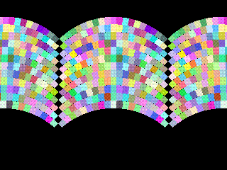

Below is a simple POV-Ray encapsulation of this. There are lots of things
you can play with, like bringing the corners in towards their centres to
give a mortar gap and randomising the size and shape a little etc. This
example uses a stone of a uniform width (BlockDepth*0.8) and you can
probably get a better looking result by reducing the width a little at the
outer edges and increasing it at the centre, but this complicates the
algorithm a little more.
Chris B.

This looks very promising, Chris!! I have to play with this in order to
understand and see how this works. Thanks!!

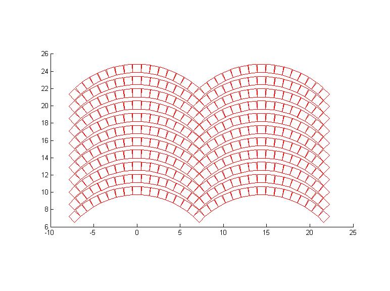

Well they are forced to 'cheat' a little, but with skill it doesn't look too
obvious.
In a perfect pattern the ones at the end of the arc would be pretty close to
square and smaller than the ones in the middle of the arc (see the POV-Ray
image I just posted). In a perfect pattern these differences could be fairly
apparent, but the craftsman randomizes the pattern a little using different
block sizes and different mortar gaps, so the 'cheating' becomes less
apparent.
As shown in the picture posted by Thomas, they don't even always pick square
blocks at the outer extremity of the arcs, as very apparent straight lines
would then form. As shown in your picture, if they used identical square
blocks they would indeed end up with large mortar gaps in the middle which I
think would be dissapointing for all concerned :-)
Chris B.

I had a bit of a play with a function to create this pattern. Obviously I'm
cheating and not using rectangular blocks. Here's the code:
 #declare Wrap = function(a) { (a/2-floor(a/2))*2-1 }
 #declare Feeder = function(x,y) { Wrap( (y -
sqrt(1-pow(Wrap(x*sqrt(2))/sqrt(2),2)))*8 ) }
 #declare Tiles =
  pigment { function {
   min(
   1-abs(Feeder(x,y))
   abs(Wrap(8.8*(-Feeder(x,y)*.1+.9)*Wrap(x*sqrt(2))))
Tek
http://evilsuperbrain.com
