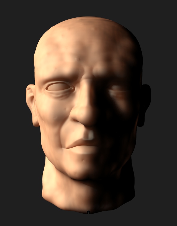

Hi,
The head was modeled first in LightWave, and then brought into Blender
to sculpt in some details. The image took 3 minutes, 6 seconds to render
(including parse time). The mesh parsed in... 7-10 seconds, and the SSS
took roughly 45 seconds to parse. I used my newly-released SSS macro, of
course. Actually, that's not completely true, since I made some
modifications to the macro so it creates a tighter effect. It still
looks quite a bit like wax, though a surface normal would undoubtedly
help things.
I'll have to eventually release another version of the proximity/SSS
macros, since I made have made some modifications to them.
Sam
> help things.
No doubt.  Also, fair pigmented skin is not nearly so smoothly colored.

Jim Charter wrote:
>> help things.
You're right. In some people you can clearly see distinct patches of color.
Sam

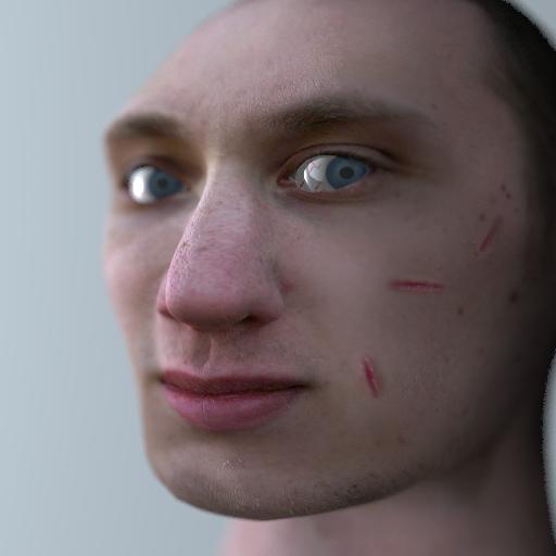

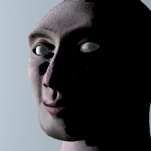

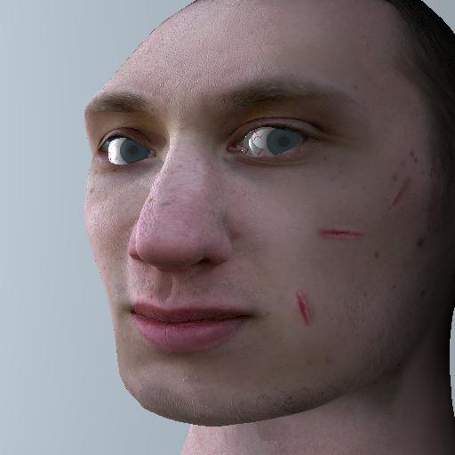

    Here is my first try with your fastSSS, using my photo-skin tests. The
first image is just the plain image_map without radiosity, and the second
is the result of just using the fastSSS pigment as a texture map pattern.
The result is even better than using media, as it has no artifacts and is
easy to setup, and indeed is much faster (even adding area_light and
focal_blur was not much slower).
   I can't stop wondering how the hell you do to figure out all these
incredible techniques... it's simply amazing. Being very selfish, I hope
your artistic side doesn't take over the technical one... ;)
Jaime

Jaime Vives Piqueres wrote:
> Hi Sam:
I'm glad somebody is using it! It seems to have worked well for your model.
It can still be pretty slow to parse. If POV-Ray supports aoi for
arbitrary points in space someday, there might be a way to trick the
technique into rendering a comparable result with even less parse time.
I spend waaay too much time thinking about rendering ;)
> Jaime
Having started CG because of my interest in art makes me wonder how my
technical side has overridden my artistic side! I want to focus my
attention from render features to feature renders ;)
Sam
