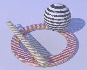

A little Monday abstract inspired (but remarkably different) by
http://brazil.mcneel.com/photos/other/images/792/original.aspx
Sources in p.b.s.
A question:
- Using a glass material and a normal, is there a way to affect the
shadows? (i.e. I want to see the effects of the normal in the shadow)
Suggestion are welcome...
Paolo
Download 'test_textures_33_1280_aa_radiosity_photons.jpg' (121 KB)
Preview of image 'test_textures_33_1280_aa_radiosity_photons.jpg'

Very nice, although a little pale overall? Like fog?
Interesting question. My uneducated guess would be no. Only possible if you
use media? I am sure there are more knowledgeable people around though...

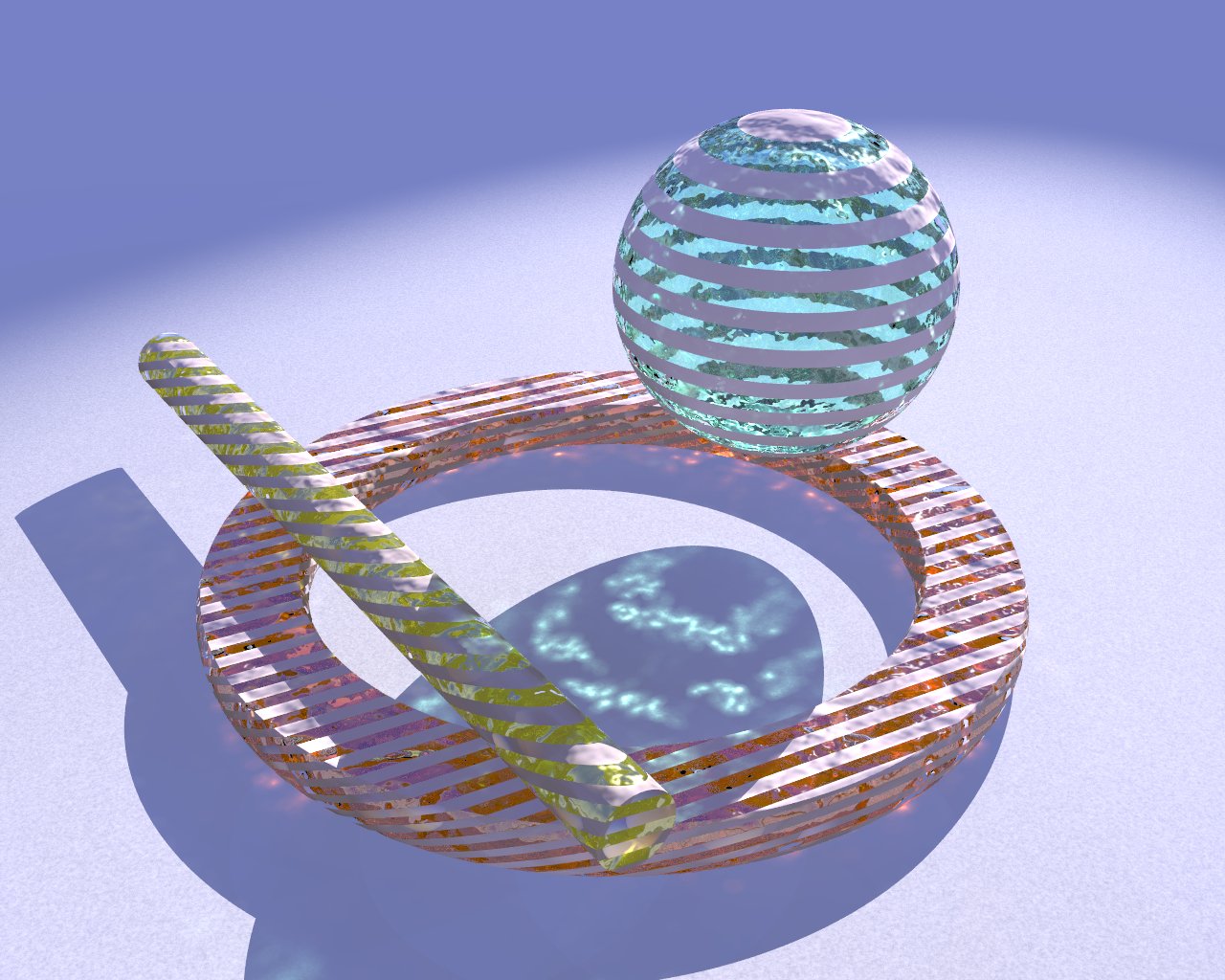

Thomas, Chambers, Blue Herring, thank you all for your help!
I've read over again the manual and adjusted photon settings in in
materials and lights. I've made some test with fade parameters in
interiors and now I'm quite satisfied with the result.
Sources in p.b.s.
Bye,
Paolo
Download 'test_textures_55_aa_radiosity_photons.jpg' (206 KB)
Preview of image 'test_textures_55_aa_radiosity_photons.jpg'
