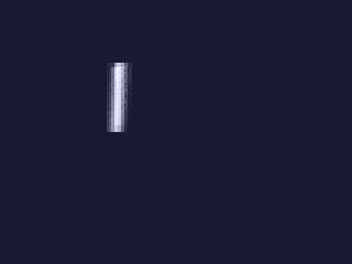

I'm plotting a continuous function in 3D with df3 files and media, using
a number of boxes with media. However, at the transition between
media-filles boxes, there are small gaps. Can someone explain why?
Attached is a rendition of two of the boxes. The df3 files have 10x10x10
entries. Below is the upper plane of the lower box in text format:
     0    0    0    0    0    0    0    0    0    0
     0    0    0    0    0    0    0    0    0    0
     0    0    0    0    0    0    0    0    0    0
     0    0    0    0    0    0    0    0    0    0
     0    0    0    0    0    0    0    0    0    0
     4    1    0    0    0    0    0    0    0    0
    95   70   39   16    5    1    0    0    0    0
   139  227  255  224  130   58   25    9    2    0
    11   35   80  135  177  198  210  170  108   55
     0    0    1    3    9   26   67  131  196  222
And the lower plane of the upper box is:
     0    0    0    0    0    0    0    0    0    0
     0    0    0    0    0    0    0    0    0    0
     0    0    0    0    0    0    0    0    0    0
     0    0    0    0    0    0    0    0    0    0
     0    0    0    0    0    0    0    0    0    0
     4    1    0    0    0    0    0    0    0    0
    94   71   40   16    5    1    0    0    0    0
   142  233  255  232  134   60   24    8    2    0
     9   32   75  129  172  196  207  166  102   50
     0    0    0    2    8   23   63  128  192  216
As far as I can see, there should be a smooth transition between the two
boxes. Can someone explain where the gap that shows in the image comes
from? I have also attached a scene file that renders this image.
Download 'df3_test.png' (13 KB) Download 'df3_test.pov.txt' (2 KB)
Preview of image 'df3_test.png'

In my opinion there is no continuity between two boxes, You have a big jump
between values in lower part of upper box and upper part of lower box (:)).
You should make it more smooth. But maybe i understand You question wrong :(.

Thanks for your reply, but I don't think so. It's probably a little
difficult to make sense of the numbers I posted before, but looking at
the left column of the numbers in my previous post (which corresponds to
the part that is closest to the camera in the image), the values of the
neighbouring voxels in the two boxes are 0-0, 4-4, 95-94, 139-142, 11-9.
Isn't that close enough? Judging from the dark band in the image, I
would have expected to find values mostly below 100 in these two slices.
Just in case anyone wants to look at it more closely, I'm attaching the
two df3 files here.
Download '00001017.df3.dat' (1 KB) Download '00001325.df3.dat' (1 KB)

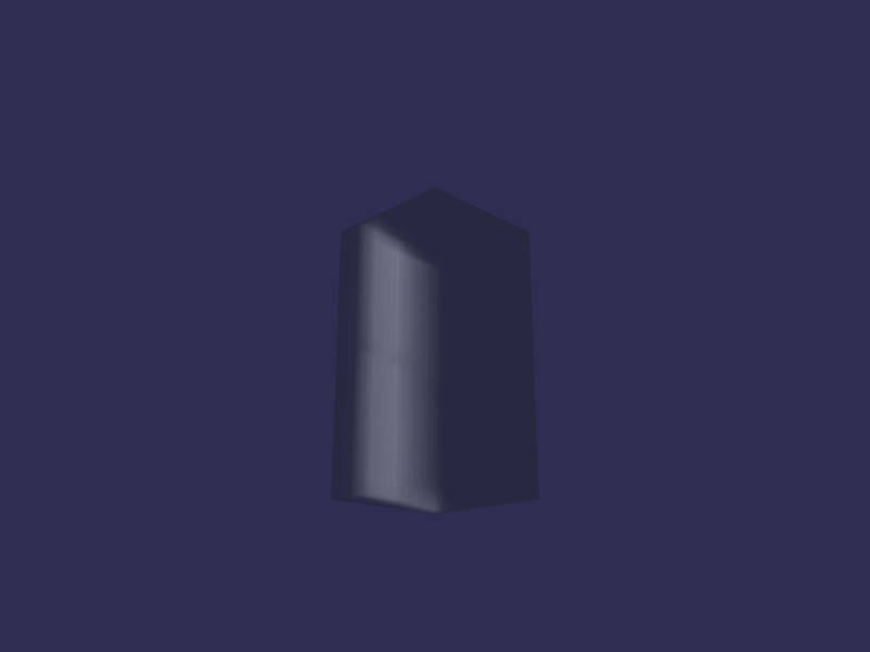

And my render.
WARNING: The consumption of alcohol may make you think you are whispering when
you are not.
Download 't3t.jpg' (8 KB)
Preview of image 't3t.jpg'

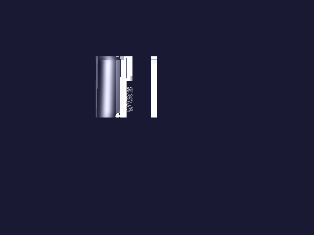

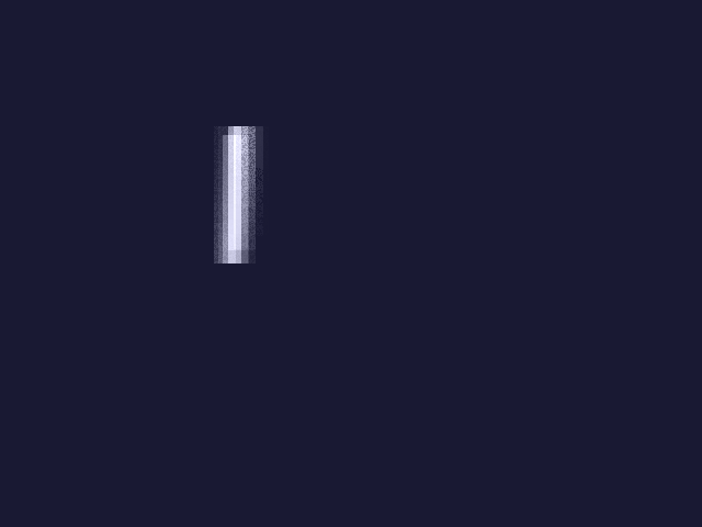

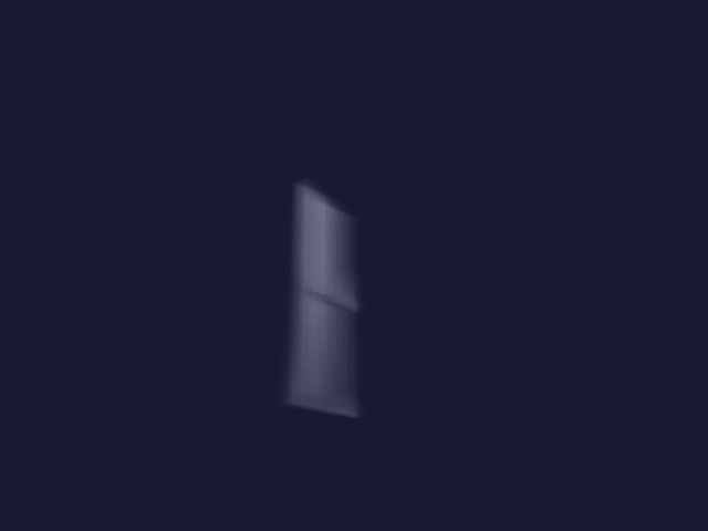

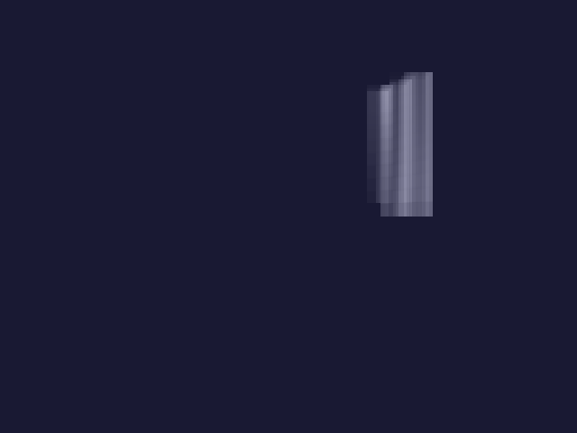

But now I have another problem with the same scene. When looking at the
media from certain angles, I get "jittery" artifacts, and sometimes the
media look like stacked planes instead of voxels. Also, when using
interpolation, the results are very strange.
See the attached images. The file df3_test-pos uses camera location
<5,0,0>, df3_test-neg uses camera location <-5,0,0>, and df3_test-int
also uses location <-5,0,0> and also "interpolate 2". The df3 file is
the same as in my previous post.
Why is df3_test-neg so noisy?
Download 'df3_test-pos.png' (6 KB) Download 'df3_test-neg.png' (10 KB) Download 'df3_test-int.png' (8 KB) Download 'df3_test.pov.txt' (1 KB)
Preview of image 'df3_test-pos.png'
Preview of image 'df3_test-neg.png'
Preview of image 'df3_test-int.png'

I did notice those stripes with an animation that rotated it in a full circle. I
don't know why it does that.
Using interpolate 1 give the best results. The gaps are more fuzzy, but still there.
interpolate 2 looks like it's broken in any cases where you have areas with a
zero value. I get similar corruption with other DF3 files as well.
Using 3.7 beta don't change the problem with interpolate 2.
