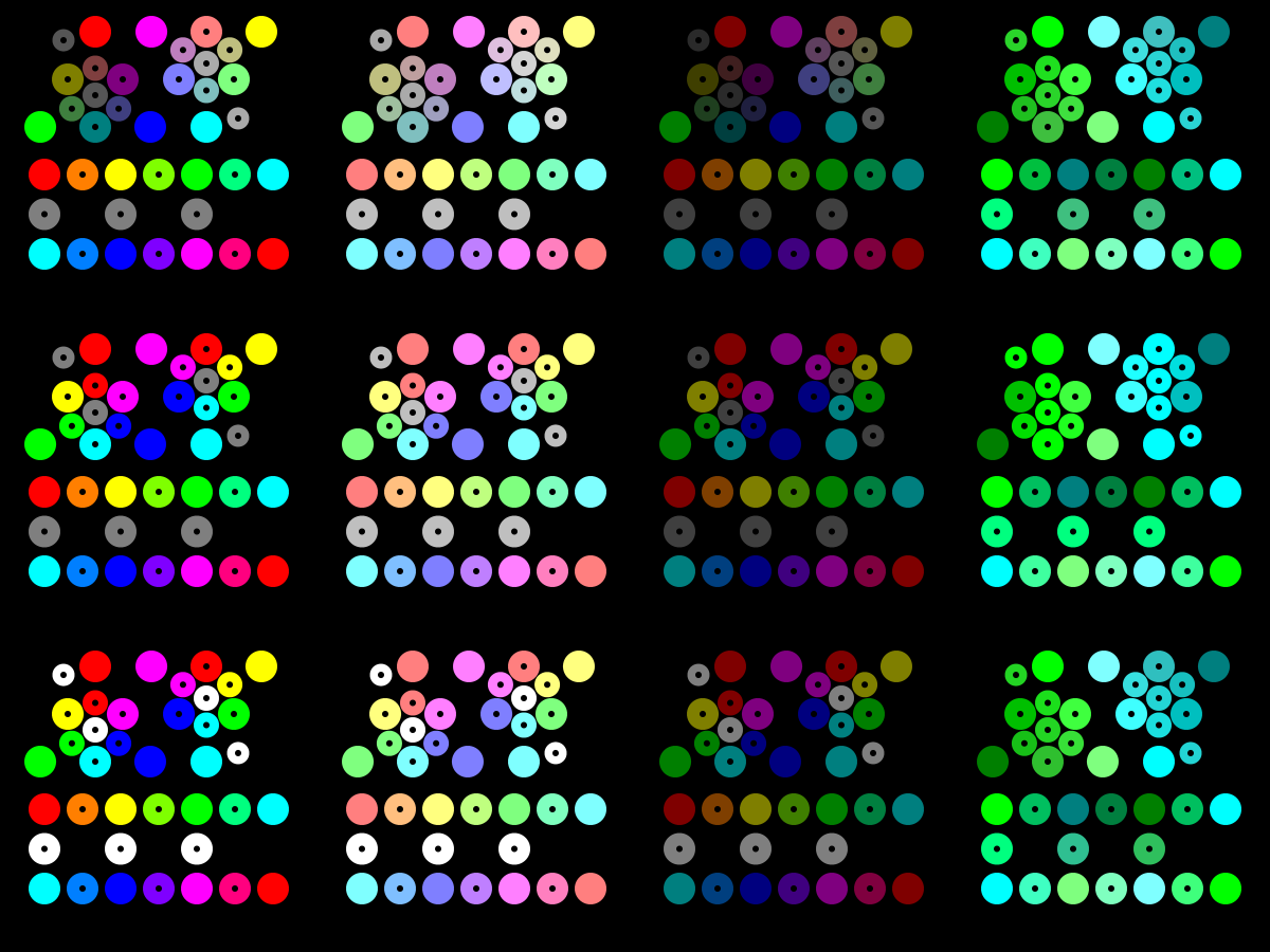

I'm wondering why, short of historical reason, does the
interpolation of weighted textures(pigment) is performed in the rgb
space.
Wouldn't it be possible to perform it in HSV or HSL space, even for
out of rgb <0,0,0> / rgb <1,1,1> block ?
And wouldn't the result be different and maybe more natural (or not ?)
Linear for SL/SV should be easy, but I'm still wondering about
interpolation of opposite hue: what would be the right solution ?
Could it be chosen per interpolation ?
Attached is a rgb interpolation of the polygon, with various
strength of mix.
The superior man understands what is right;
the inferior man understands what will sell.
-- Confucius
Download 'demoexpl.png' (221 KB)
Preview of image 'demoexpl.png'

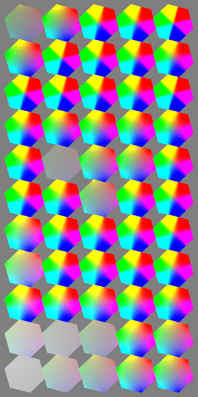

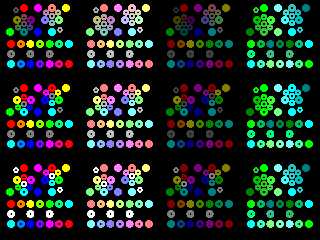

I had a try with RGB (the pov current way), HSL & HSV. (see attached
picture)
First row is RGB interpolation
Second HSL
Third HSV.
There is no point in trying YUV/YIQ/Secam/Pal/NTSC... colorspace as
they are matrix transformation of RGB, and as such keep the same result.
First column is Pure colours (<1,0,0>),
Second column is Light colours (<1,0.5,0.5>)
Third column is dark colours (0.5,0,0),
Fourth column is Green & Cyan, with dark & light.
The original colours are in full-disc.
The interpolated colours are in opened-disc, at mid-way between the
used colours. The center open-disc is the interpolation of the three
original colours. The opened-disc on the side is the interpolation
of the three first-level interpolation.
There is differences!
For the management of Shades, I prefer HSL: mixing dark & light
gives normal, which does not happen for HSV nor RGB!
-- Confucius
Download 'melange.png' (199 KB)
Preview of image 'melange.png'

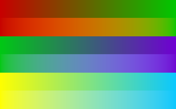

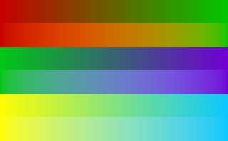

Oh I knocked up a quick program to interpolate between two colours in RGB
space and Yuv space.  In each pair, the top version is RGB, the lower
version is Yuv.
Actually, I just realised, you were probably thinking of the YUV signals
used in TV, that are just linear combinations of RGB.  I'm talking about the
CIE Yuv color space, revised in 1976 so that colours are spread equally in
the uv plane.  See:
http://hyperphysics.phy-astr.gsu.edu/hbase/vision/cie1976.html
Download 'interpolation comparison.png' (3 KB)
Preview of image 'interpolation comparison.png'

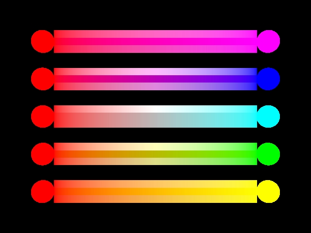

> picture)
I've been having a look at this.  One problem in your graphic is the
interpolation of opposite colours in HSV and HSL.
You are basically interpolating linearly between individual H,S and V/L values.
The interpolation of H is done in the shortest direction around the
circumference. This poses a problem because there is no logical way to choose
the direction to interpolate H around the circumference, as both directions are
equal in length, so you have chosen to interpolate directly across the colour
space, which creates a discontinuity (eg: check the interpolation of
<1,0,0><0,1,1> compared to <1,0,0><0.001,1,1>, they should be virtually
indistinguishable, but the slight value added to the R value tips the shortest
route from being undefined to defined).  It would be far better to interploate
all colours directly across the colour space to remove this discontinuity.
A second problem I see is that this really only shows the halfway colour, and
not the full transition from one to the other.
The attached image shows interpolation between pure red and the other 5 pure
colours using interpolation across the colour space as described above.
top band: HSV
middle band: RGB
bottom band: HSL
Looking at this, RGB interpolation seems to give the most pleasing transition to
the eye (my eye at least).
-tgq

From: Le Forgeron
Subject: Re: texture interpolation... why rgb ?
Date: 29 Nov 2007 15:52:44
Message: <474f269c$1@news.povray.org>
Le 29.11.2007 21:29, Trevor G Quayle nous fit lire :
>> picture)
Did you look at my code in p.b.sf ?
H was not linearly interpolated. There is a bit of vectors involved.
RGB or HSV/L: red & cyan mix as a shade of grey. (null saturation)
If one is shorter than, it is defined...
Now, should the path be alike is another problem: at any moment you
will have to choose between the upper path and the lower path...
There is two ways for opposites on a circle. And no good choice.
I did as I could in SDL. Patching lighting.cpp around line 5251 is
an idea I'm not yet ready to perform for a continuous gradation. Not
tonight anyway.
May be next week... but I want more control than changing it from
RGB to HSL/HSV hardcoded.
So reflexion is needed before trying that.
A problem with your picture: it only uses saturated colors. What
about lighter, darker, white & black ?
Mixing a lighter blue & darker blue ? Not a saturated blue in RGB model.
