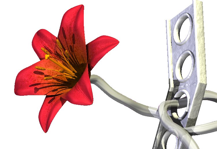

I'm working on a partially abstract image with a flower and some metal. It's
part of a larger work that will consist of several images. So far I've been
focusing on the overall structure, while not paying too much attention to
the small details in the image.
For this reason, some elements in the image look very crude. The flower is
an exception - I have worked on the details here, but the stem and the metal
are very simplistic. I could use some suggestions with that.
A few notes about the image:
- The flower is fictional. The flower itself is like a type of lily, but the
stem is more like a vine, climbing objects.
- The stem will stay white (or gray) in the final image. The deep red color
of the flower will be the only color in the image. The stem is also a bit
transparent. I'm looking for extreme close-up reference images of stems...
- The two parts of the metal are supposed to look like they're welded
together. I don't really know how to do that.
- The metal shape looks very crude to me, but I don't know what kind of
details I can add to make it look more real. Note that the metal shouldn't
look too old and worn - it's supposed to be somewhat shiny and new.
Comments appreciated!

Maybe my impression is skewed by the movie I'm watching but that flower of
yours looks like it's on the attack.... or at least on-the-prowl. :)

Looks already impressive, Rune. A couple of thoughts that come to mind:
I think that the transition between flower and stem should be gradual
(organic>>inorganic) so the flower color should smoothly go into the
metallic color. Not over a large distance, just so that it is noticeable
(perhaps to the first bend).
I think that the welds you have already made are good. Perhaps on the sides
too?
I am a bit troubled by the bumpy aspect of the metal though. This does not
evoque metal to me. Perhaps you could try a brushed metal? Bumps like these
make think of rust as a matter of fact.

Rune nous apporta ses lumieres en ce 2007/06/30 22:56:
Very nice, I regularly see real flowers remarcably similar to this one, exept
for the steem.
The weld looks good to me, just bring the bumpy part on the sides to. Maybe
adding some light yellowish/brownish hue to the welds: real welds tend to have
some colouring.
It looks like cast metal from a rough, mediocher, sand mold. If you go for shiny
and new, make it smoother, non-bumpy, but with more linear threaks. Girders are
normaly extruded, not cast.
The holes, if any, are then cut out and, optionaly, a reinforcing ring welded
in: you may want to add some welding bumps there to.
> flower of yours looks like it's on the attack.... or at least
> on-the-prowl. :)
Hehe, funny, but that's not the intention. :) I think it will look more
harmless when seen in the bigger picture that thyis picture will be part of.
Rune
> mind:
> noticeable (perhaps to the first bend).
I already tried that earlier over a large distance and it was distracting,
but now that you mention it, it may actually work quite well if just the
distance is very small. I'll try that out.
> sides too?
Yeah, I'll work on that.
> does not evoque metal to me. Perhaps you could try a brushed metal?
> Bumps like these make think of rust as a matter of fact.
Hmm. Brushing metal is something done intentionally to make it look nice,
right? I don't think that is done to girders (thanks Alain for pointing out
the word for them), which is what this is supposed to look like. Normally,
girders are made to support tructures, not to look nice. So I'm trying to
get a "new, but not polished" look. However, I'm not sure what that is,
exactly...
Rune
http://runevision.com
>> but the stem is more like a vine, climbing objects.
> one, exept for the steem.
Thanks. :) I think I'm done with the petals, but the stamens and the pistil
need a little more work.
> Maybe adding some light yellowish/brownish hue to the welds: real
> welds tend to have some colouring.
Interesting. Would you know how to find some reference images of this? I
haven't been able to find any that show this.
>> of details I can add to make it look more real. Note that the metal
>> shouldn't look too old and worn - it's supposed to be somewhat shiny
>> and new.
> go for shiny and new, make it smoother, non-bumpy, but with more
> linear threaks.
Is threaks a typo for streaks?
> Girders are normaly extruded, not cast.
> ring welded in: you may want to add some welding bumps there to.
Very interesting! Again, I haven't been able to find any reference images.
If you know of any, please let me know.
Rune

Rune nous apporta ses lumieres en ce 2007/07/03 07:38:
Very good as it is now! If, in the final render, the flower is relatively small,
more work probably won't show.
I don't have any picture showing it, I've had many ocasions to actualy see real
fresh, and less fresh, welds up close. Arc welded cast iron, steel, stainless
steel, copper, brass...
>>> and new.
>> linear threaks.
Oups!
> Rune
