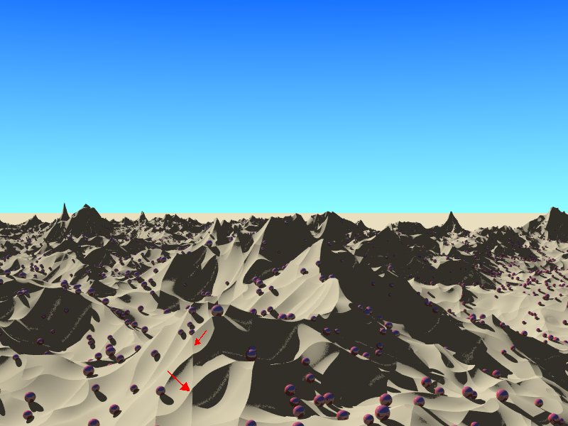

High!
When rendering several views of a simple isosurface landscape (with
hetero_mf being used as main function), a strange effect occured:
shadows are cut by straight lines like indicated by the red arrows in
the attached picture. I remember having read about this problem here
several months before here, perhaps even in 2006, but I couldn't find
the respective posting...
Is there a way to fix this?
See you on www.khyberspace.de !
Yadgar
Now playing: Don't Work That Hard (Scritti Politti)
Download 'ghurghusht_flat_0027b_looking_southwest_arrows.jpg' (76 KB)
Preview of image 'ghurghusht_flat_0027b_looking_southwest_arrows.jpg'
From: Joerg
Subject: Re: Strange artifact in isosurface landscape
Date: 30 May 2007 07:39:38
Message: <465d627a$1@news.povray.org>
do you have the double_illuminate keyword with your object?
have a look here:
http://www.povray.org/documentation/view/3.6.1/329/
I once had similar problems with some heightfields and could fix it using
double_illuminate
Regards
Joerg

From: Christian Froeschlin
Date: 30 May 2007 11:10:20
Message: <465d93dc@news.povray.org>
Looks like these lines are present in the geometry itself.
Maybe reposition the camera to check it out.
From: def gsus-
Date: 30 May 2007 17:25:02
Message: <web.465deb178fca644cbd61fc7e0@news.povray.org>
according to the shadows of the spheres the lightsource is relatively low.
so it looks quite normal to me. the straight lines seem to come from the
isosurface's function.
