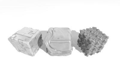

In a scene I am working on, I am building it up with just plain primitive
boxes but when I have the layout all done, I'd like to make them isosurfaces
so I can deform them with noise or pigment functions. I couldn't figure out
an easier way than make a macro that takes the same vectors that define the
box, plus some other parameters, resulting in an isosurface.
This may not be usefull for anyone else but me (meaning, it works on the
scale I'm working with, your results may vary... and it's not tested
heavily), but here's the macro and sample output.

Download 'isobox3.png' (29 KB)
Preview of image 'isobox3.png'
From: povray

  0:00:00 Parsing
File: isobox_macro_posting.pov  Line: 30
File Context (5 lines):
// vB1 = box vector 1
// vB2 = box vector 2
// fRad = radius for f_rounded_box
// vT1 = deformation translate vector (moves the function away from the
origin
Parse Error: Expected 'object', undeclared identifier 'origin' found instead
Total Scene Processing Times
  Parse Time:    0 hours  0 minutes  0 seconds (0 seconds)
  Photon Time:   0 hours  0 minutes  0 seconds (0 seconds)
  Render Time:   0 hours  0 minutes  0 seconds (0 seconds)
  Total Time:    0 hours  0 minutes  0 seconds (0 seconds)
From: Marc
Subject: Re: isoBox macro
Date: 18 Nov 2006 19:12:16
Message: <455fa160@news.povray.org>
news: pan.2006.11.18.17.26.29.215251@localhost...
instead
it is a broken in line comment (//)
the post broke the line (in the parameters at the beginning of the code)
> origin)
(guess if it will be broken again)
just comment "origin" as well or delete the  carriage return and the >
character
Marc

Very nice little macro, Ross! Thank you!!

"Marc" <jac### [at] wanadoofr> wrote in message
news:455fa160@news.povray.org...
> instead
> > origin)
> character
> Marc
Yep, thanks for clearing that up Marc
