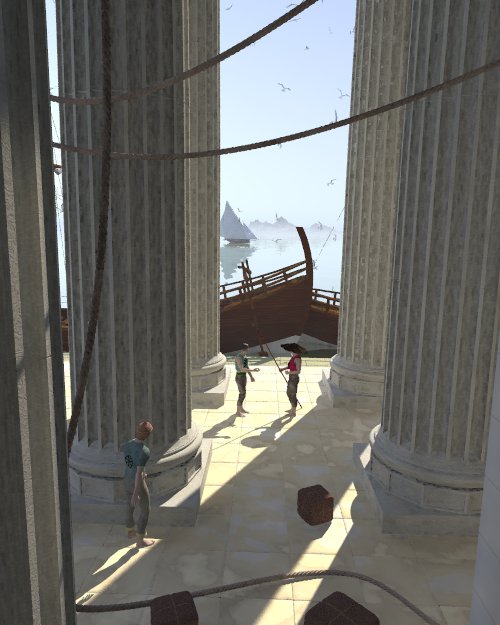

I need your expert comments :-)
This is the first serious render of the scene with radiosity. It is a 2-pass
job (first gathering radiosity data on an image half the size of this one;
took about 5+ hours; second pass was just about 45 minutes). There are still
ugly artifacts visible, especially on the columns. What is the best way to
go from here? I include the radiosity settings used so far. Normal and media
are off; Megapov settings were used
Thanks for the help!!

Is that texturing you added to the columns and tiles or is that the
artifacting?  If it is, it almost looks like a nice texture.  ;)
Typically I drop the recursion limit down to 1 or 2 and jack the count
setting way up.  Although a significant portion of your image is in the
shadow, and with the nooks and crannies in the architecture you are
using, keeping it at 3 is probably best.  You might want to try 2 and
see if you can get away with it.  The reason you'd want to lower it is
to save time, because your count is way too low.  I'd bump up to 1000 at
least, and at a recursion limit of 3 thats going to take forever.
The biggest factor here might be your error bound.  A value of 0.1 is
very accurate and requires a very high count (and ages to render).
Maxing out at 1600 you are still going to see artifacts probably.  I'd
raise that up to at least 0.5 and you might want to go all the way to 1.
  Your lighting won't be as accurate but it will be much smoother.
Remember, as your error bound lowers, the count has to go up.
Nearest count could also be increased to take a few artifacts out.

From: Tim Nikias
Subject: Re: Eavesdropping WIP - radiosity issues
Date: 14 Sep 2006 13:07:08
Message: <45098c3c@news.povray.org>
Well, what I usually do when using the two-pass method, is to use a
lower error_bound on the first pass, and double or quadruple (always 2
with an exponent attached) the error_bound on the loading pass. What
this does is average more of the samples together, in effect smoothening
the radiosity results somewhat. Of course this leads to loss of details,
but detailed errors are smoothened away as well. You could have a look
at my website as well, I've experimented a little with radiosity some
time back:
http://www.nolights.de/projects/radiosity/radiosity.html
Hope that helps, even if just a little.
Tim

    That's what I wanted to say! Really, I admire Thomas' work, but I too
have no experience with Rad, and consequently, don't know what an 'artifact'
is. When they're spoken of, I always find it hard to see what the author is
seeing.
      I actually see this image as an improvement on the last one. It looks
good to me.
       ~Steve~
I don't understand your use of the MegaPOV adaptive error_bound - if you
use it in the first pass you will loose control over the accuracy of the
radiosity data taken and stored.  Furthermore using tighter settings in
the final pass will increase the number of samples taken there (and
using always_sample off at the same time could lead to low quality).
I would try to decrease recursion_limit to 2 and use the saved time to
improve quality if that does not change the appearance too much.

Yes, a good question Skip and Steve! I am not sure what it is. I use an
averaged texture for the columns and I think that partly it is texture what
you see. But only partly. I suspect them to be mostly artifacts because the
texture without any radiosity or fancy adds looks much smoother, especially
at the middle distance.
> good to me.
Thank you Steve! I thought so too. I always try to put radiosity in because
the look becomes more natural. However, the render times and the tuning of
it is really arduous in my experience.
> the final pass will increase the number of samples taken there (and using
Thanks Christoph! I had not realised the consequences of the adaptive
error_bound in the first pass. Quite simply I thought it would - at the same
time - speed up calculations and increase accuracy! Well well well... Things
are never as simple as one believes...
Date: 15 Sep 2006 03:17:34
Message: <450a538e$1@news.povray.org>
"Tim Nikias" <JUS### [at] gmxnetWARE> schreef in bericht
news:45098c3c@news.povray.org...
> Well, what I usually do when using the two-pass method, is to use a lower
> error_bound on the first pass, and double or quadruple (always 2 with an
> exponent attached) the error_bound on the loading pass. What this does is
> average more of the samples together, in effect smoothening the radiosity
> results somewhat. Of course this leads to loss of details, but detailed
> errors are smoothened away as well. You could have a look at my website as
> well, I've experimented a little with radiosity some time back:
Thank you Tim, I shall visit again your site. Everything helps. I try to
understand what I am doing especially by studying what others have done,
however with radiosity this is not always easy.
