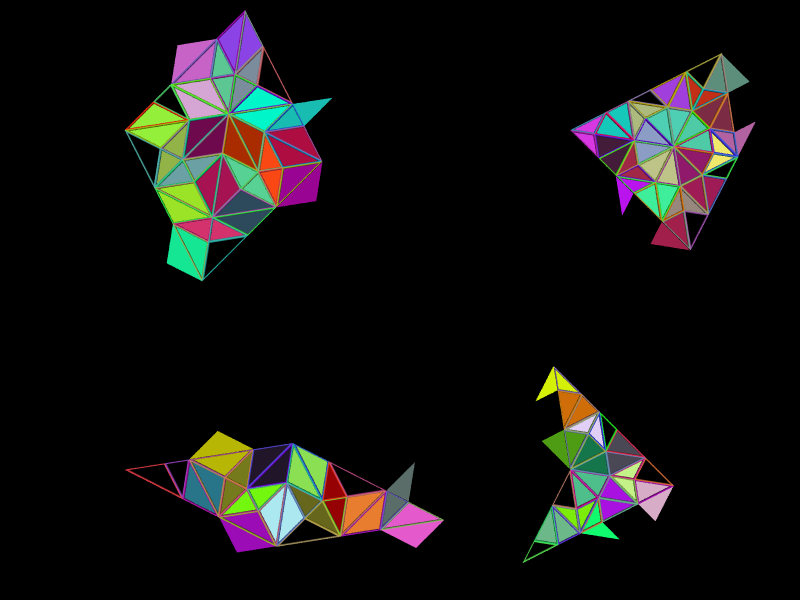

For these test images, I stripped off all the curvy tile decorations of
the last images, but did put that new context parameter to use.  The
first image is just two rhombs, a kite, and a dart expanded a few times.
The edges of each triangle are shown, but each rhomb, kite, or dart is a
single color.

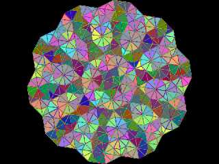

The second image is a cartwheel pattern.  The dark spokes will travel
off to the far edges of the plane.  Each spoke can be reflected, and 10
spokes make for 1024 combinations, but only 56 different ones, the rest
are reflections or rotations of those 56.  (The light colored ring in
the center determines all this, and is called a decagon.) This
particular cartwheel pattern is the only one that can be properly filled
at the center.  Other patterns to to get exact 5 way symmetry from the
central point out are the sun and star, inflated and even number of
times to what ever level you desire.

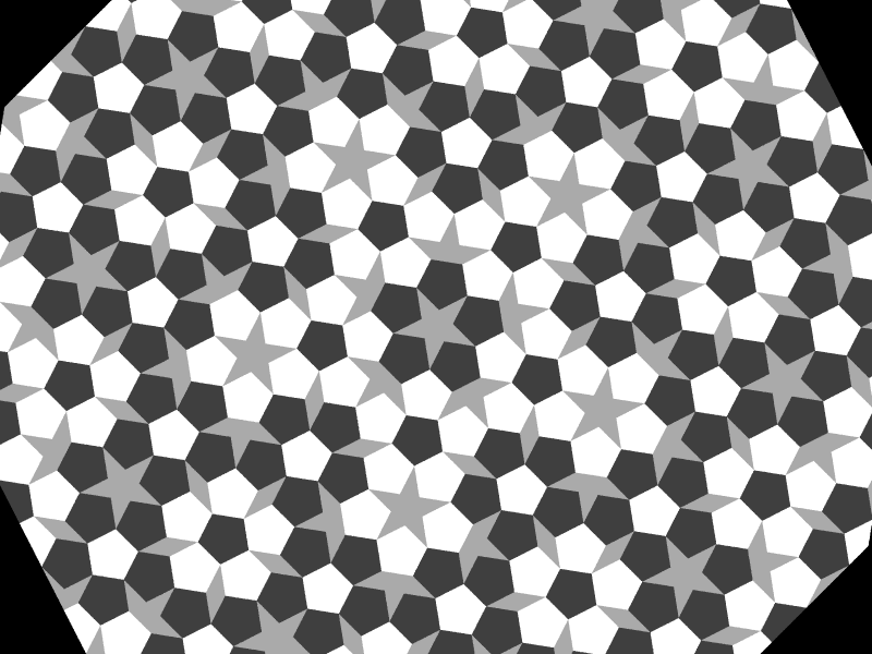

The third image I just did in the last few hours, and wanted to get the
pentagon tiling that has been seen around here on a regular basis.  It
might be interesting to put curves all over it, but I resisted to keep
the demonstration code shorter and simpler.
