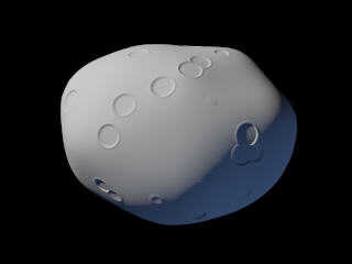

Several days have passed, and I tried to improve the appearance of my
asteroidal moon, mostly be applying additional 3D noise to the surface
(in the case of the image attached here, by replacing the original
noise_3d(x, y, z) by noise_3d(pow(x, 3), pow(y, 3), pow(z, 3)), which in
fact added subtle waves to the terrain relief).
But still the problem is, that with the crackle pattern (with form set
to <n, 0, 0>), the craters are in fact "bubbles" of empty space
distributed randomly inside the raw isosurface moon body and not
necessarily cut in half by its surface, so that many craters still are
gaping holes rather than shallow depressions.
How can I get rid of this? Is there something like UV mapping for
isosurfaces which guarantees that only craters cut in half by the
surface are generated?
Is it possible to write a "core function" which, on the x-y plane,
generates a roughly symmetric (perhaps slightly turbulated)
cross-section of a crater, with terraced walls, a rim higher than the
surrounding terrain and even a central peak, which then is transferred
to a circular structure by applying trigonometric functions (?), which
in turn are distributed randomly (also with random variations in depth,
diameter, terracing and height of central peak) across the existing
asteroid surface?
Where can I find the mathematical resources to design such a function?
See you in Khyberspace!
Yadgar

You could create the isosurface without holes then use trace() and
difference out the craters, but that doesn't help with the rims.
You could use trace and a blob rather than an isosurface, but again
the rims are tricky (or impossible).
You might be able to add the crackle pigment as a function to
the isosurface, but I'm not sure how that would turn out.

Interesting approach... perhaps I would even be able to generate halfway
believable rims!
This is exactly what I did in my current attempts!

Thought I'd have a go at this one...
// Asteroid
#version 3.6;
#default{finish{ambient 0}}
#global_settings{assumed_gamma 1.0 max_trace_level 5}
#declare f_bozo1 = // similar to noise3d
function{pigment{bozo scale 0.5 color_map{[0 color rgb 0] [1 color rgb 1]}}}
#declare f_craters =
function{
  pigment{
    crackle form <1.2, 0, 0> // never really played with this one, thaks
Yadgar!
    scale 0.3
    color_map{
      [0.00 color rgb 1.00] // centre of crater, lowest part
      [0.30 color rgb 0.80] //
      [0.35 color rgb 0.40] // rim, higher than surrounding area
      [0.40 color rgb 0.5] // level of area outside the crater
      [1.00 color rgb 0.5]
the f_craters function is subtracted from the basic asteroid shape, so the
lowest points get the highest numbers, since you are subtracting more.
isosurface{
  function{
    (x*x)+(y*y*1.8)+(z*z*1.5)-1 // basic sphere function, scaled to be more
elliptical
    +f_bozo1(x,y,z).red*0.35 // deforms the ellipse shape
    +f_craters(x,y,z).red*0.05 // adjust the '*0.05' part to change the
depth of the craters
  contained_by{box{<-1, -1, -1>, <1, 1, 1>}}
  threshold 0
  accuracy 0.001
  max_gradient 4
  texture{pigment{color rgb 1} finish{diffuse 0.6}}
light_source{<-10, 10, -5> color rgb 1}
light_source{< 10, -10, -5> color rgb<0.2, 0.4, 1.0>*0.25}
camera{
  location <0, 1, -4>
  up y*(image_height/image_width)
  right x
  sky y
  look_at <0, 0, 0>
  angle 36
// -------------------------------------------------- end of file

A potato-cheese with holes! Delicious! Nyam!
Doesn't looks very realistic. Might be, the crater edges are to straight.
And the entire object (asteroid and craters) is too regular, somehow. Not in
shape, but in surface characteristica. Too plain. Too smooth.
I believe you would be well-advised to consult photos of asteroid or moons
surfaces to get some good ideas. Surfaces are not really plain but bear tiny
difference in surface heights and surface roughness.
But your project is promising. Go on, and you will create a great model of
an asteroid!
Yes, I've seen this on close-up NEAR photos of (433)Eros... and I had
some headache to find out how to add such small-scale noise to the
surface! Should I try noise_generator_3d rather than noise_3d?
