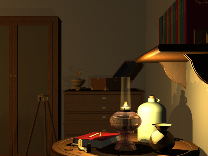

This is a circa 1860's surveyors office. I've been working on this off and
on for the past several months. The objects were a piece of cake, but
setting up the scene was especially hard. I finally settled on this view.
Obviously the hurricane lamp is a light source, also a light from outside
the window. I stuck a tree outside the window to break up the plain shadow
that the outside light was casting on the wall behind the lamp. I also had
to add two shadowless light sources to add some illumination to the rest of
the room, after I dialed down the light from the lamp (it was too harsh on
the jug and spitoon). I ended up rendering with v3.5 as I was having AA
problems with some of the torii in the bright area's. Anyway there she be
.... how'd I do?
Jim

The scene suggests a theme and composition that has been carefully and
methodically worked out.

It looks like a comfortable place to sit down for a bit.  :-)  Nice
modeling.  I'm not experienced in using radiosity myself but I'm pretty
sure you've got a scene which would benefit from it.  I don't think it'd
hurt to let the background be a little dimmer if it's supposed to be a dark
room, maybe a little more contrast.  Otherwise thumbs up
Charles

The entire scene looks interesting. I like the items.
However, I am not sure yet, if the light is entirely correct. Somehow, the
scene does not look realistic enough as it could do, don't you agree? But
please do not expect I could tell you what exactly causes that, I couldn't
it is just a recognition. I think, if you manage that light issue, you have
done a gorgious scene. As said, the scene itself is wonderful and kind of
nostalgic. Please go on! And publish soon more views, more rooms of that old
1860 house, and maybe the African landscape around it (don't know why I put
your scene to Africa - just a feeling).

Thanks for the comments .... two of you touched on the lighting issue. I
would agree that perhaps a bit of tweeking is in order. I too haven't had
much experience with radiocity but think that's a step  in the right
direction!
