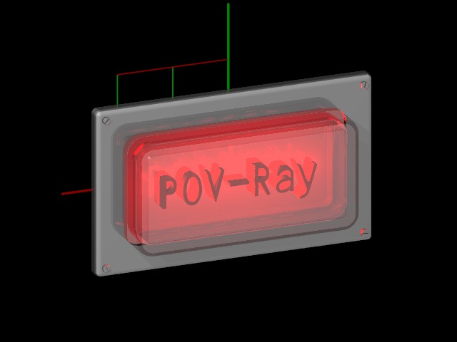

Hi,
I'm working on some buttons for a website. It's far from complete but here
is the first result.
I'd like to put some lights in the button so that I get the effect that the
text inside the glass is emitting light. It's should then illuminate the
rest of the button.
So far I haven't found a good method to achieve this. I tried area lights
but the the letters start casting shadows. I've also tried to put some
cilinder  with rounded top & bottomwith transparent media around the text.
But this didn't look very nice either.
Anybody has a suggestion how to make text that emits light and how to get a
kind of halo effect around the text?
I also tried lights and looks_like with the text inside but that didn't seem
very realistic either. Looks like a light spot in the center of the text.
Here is the code w media I tried
   #declare meditextsfer=material {texture {
    pigment {
                rgbt <0,0,1,1>
    finish{
        ambient 0
        diffuse 0
    interior{
        media {
                intervals 30
                ratio 0.9
                samples 2,4
                confidence 0.9
                variance   1.0/128.0
                method 1
                absorption <0,0,0>
                emission <0.6,0,0.0>
               //scattering {1, <0,0,0.12> extinction 1}
                density{ spherical
                        turbulence 0.0
                        density_map {
                                [0.0 color rgb 0]
                                [1 color rgb 1]
 #declare meditextcyl=material {texture {
    pigment {
                rgbt <0,0,1,1>
    finish{
        ambient 0
        diffuse 0
    interior{
        media {
                intervals 30
                ratio 0.9
                samples 2,4
                confidence 0.9
                variance   1.0/128.0
                method 1
                absorption <0,0,0>
                density{ cylindrical
                        turbulence 0
                        density_map {
                                [0.0 color rgb 0.0]
                                [1 color rgb 1]
 //media
shine ----------------------------------------------------------------
        object{
#declare len = 2.5;
#declare radi=2 ;
                merge{
                      sphere {<0,0,0>,radi hollow material {meditextsfer} }
                      cylinder {0*y,  len*y,  radi open hollow material
{meditextcyl scale <1,len,1>} rotate z*-90  }
translate <0,0,0> } translate <len,0,0>}
                 translate<-1,0,1>
Download 'buttontest.jpg' (34 KB)
Preview of image 'buttontest.jpg'

How about using sphere_sweeps to make the text rather than text, then
filling them with emitting media, like a neon tube?
Example <a
href='http://www.onewhiteraven.com/gallery/minimalism/target0.html'>here</a>
Joanne

May work,
but problem then is that you can't just use the string/text functions to
change the text. you would need a set of macros and a sweeped sphere
alphabet to be able to change the text easily. Anybody has such object&code?
I'm writing a macro for the button that has the text as a parameter.

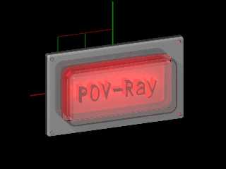

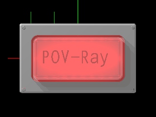

Here's a new render
I've put 8 lights under the ruby glass cap which is below the white glass
cap.
Looks a bit better, but still far from what I have in mind.When the text
itself could emit light that would be much nicer.
I think the final render should become more glossy. Maybe making the glass
cap on top thinner makes the colors somewhat more brilliant. I still have to
experiment with the glass textures. I think the inner colored glass should
be more matt so that it disperses the light. The outer glass should be
lighter I guess

Have you tried with radiosity? That way, the text can actualy emit light.
My suggestion:
Make the text a little thicker and difference it with a box.
difference{object{<your text object>finish{diffuse 0 ambient 1}}box{corner1,corner2
finish{diffuse 1
ambient 0}}}
Give the text object a finish with ambient 1 or a little more, and the box with
ambient 0. In a
radiosity scene, this makes the sides of the leters emit light that will illuminate
it's surrounding
and the part cut by the box will remain dark.
Please note that that light CAN'T interact with any media.
You can also make the leters transparent, hollow and fill them with emiting media.
Those can emit
light in a radiosity scene if you add "media on" in the radiosity block.
