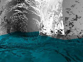

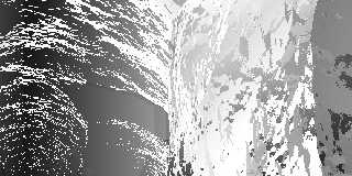

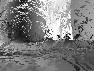

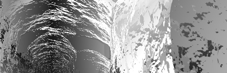

Here are a couple of images to illustrate the response I posted on
povray.general to a question on using object patterns as isosurfaces.
It's just a set of merged tubes with turbulence added to try to emulate the
style of the underground caverns from the laser scanned fly-through that was
posted in the animations newsgroup a few weeks back. The camera is looking
down the inside of one turbulent tube with various branches off it.
The smaller image took about half an hour to render with a max_gradient
setting of 200.
The other uses a max_gradient of 2000, but is only a partial render because
I gave up after 20 hours.
Chris B.

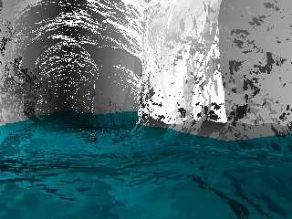

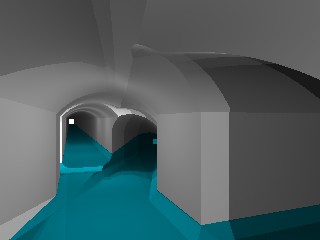

Nice thought, so here's one with a blue/green layer, though the water I've
seen in caves has tended to look pitch black.
Plus one of the same object rendered directly rather than through an
Isosurface pattern.
The isosurface version took 1h 18min to render versus 4 second for the plain
one.
Chris B.
