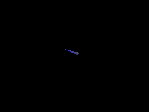

I'm trying to render a mesh2 and am running into some problems with the
pigment on individual triangles.
The following scene is a single mesh2 face that was painstakingly
isolated so that I could better understand the problem.
The first image is the render of the scene - a white triangle, not the
expected results.

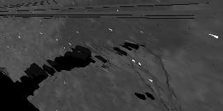

But if I modify one of the vectors I get something similar to image #2.
image 2 - modify vector 1
<57312.569,784.27165,53547.105>,  original
<57312.568,784.27165,53547.105>,  modified

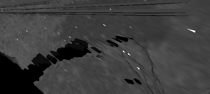

But results vary with what I modify - image 3
image 3 - modify vector 2
<57310.236,784.35367,53548.234>,  original
<57310.237,784.35367,53548.234>,  modified
Image 4 is what the big mesh looks like with the little white faces
sticking out like a sore thumb.  The white face on the far right is my
example face that I was able to isolate.

From: Shay
Subject: Re: mesh2 coloring problems
Date: 10 May 2006 12:45:05
Message: <44621891$1@news.povray.org>
Tom Austin wrote:
> Maybe someone has some info that might help me out.  The only thing
> I can think this could be is the scaling problem that comes up when
> someone tries to render our solar system and a pencil on earth in
> real scale in relation to each other - something to do with working
> with really large and really small numbers at the same time.
Have you tried search/replace the camera and vertex_vectors sections
'>/10' for '>'? Fixes your examples.
  -Shay
From: Tom Austin
Date: 11 May 2006 08:40:51
Message: <446330d3$1@news.povray.org>
You are saying scale down the scene by a factor of 10- right...
I don't believe that we've tried a pure scale like that on the whole
data set.  I'll have to try it to see if it kills the problem.
For now we translate the whole thing closer to the origin.  It's worked
for now, but if we have to do more of this work, it might not.
I am curious as to what causes this behavior in POV-Ray. When one
understands the cause, then one has the ability to avoid it.
Thanks for your help
Tom
