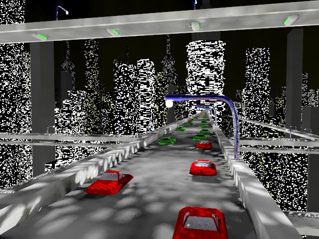

I know I should be able to get this by now, but somehow it's not penetrating
my brain.
I have an outdoor night city scene and I have placed spotlights on the
ground and I want the media to do 2 things.
1. show the light being cast upwards through the city
2. make the distant buildings less clear.
There is a lot of radiosity lighting in this image too, which seems to
complicate things.
Here is the current thing...  I'm using a very big sphere to contain the
media.
Download 'City(rad+media).jpg' (103 KB)
Preview of image 'City(rad+media).jpg'

Try turning off radiosity and working with just the media. Better yet,
make sure you're using the "hollow" keyword on the containing object.
~Mike

ok, but do you see all those streetlights?  They would have to become
light_sources, wouldn't they?

Ah! Therein lies the problem:
Scattering media is not affected by Radiosity. Media can affect
radiosity, though, but not the other way around. (i.e. Emitting media
can be used to create a glowing gas cloud that lights the room...)
In short, yes, they need to be light sources. Sorry...

Here's one solution to problem #1 (I'm asuming that your spotlights on the
ground are pointing up):
Start with a media sphere of unit size (I find that this makes media-filled
objects more understandable as to how they behave)...
sphere{0,1 hollow
 pigment {rgbt 1}
interior{
 media{
  scattering{1, <...color...>*2 // or whatever multiplier looks appropriate
   extinction 0
   method 3 // the default
   intervals 1 // the default for method 3...the POV docs are incorrect here
   samples 100,100 // or even higher
 scale 10 // or whatever
The extinction 0 value makes the media disappear EXCEPT where the spotlights
hit it. (The spotlights should probably have some fade distance/fade power
as well, to look more realistic.) Depending on how big your media sphere
ends up being, the samples values may need tweaking. If they're too low,
you'll see "discontinuities" in the illuminated media.
Hope this helps.
Ken W.

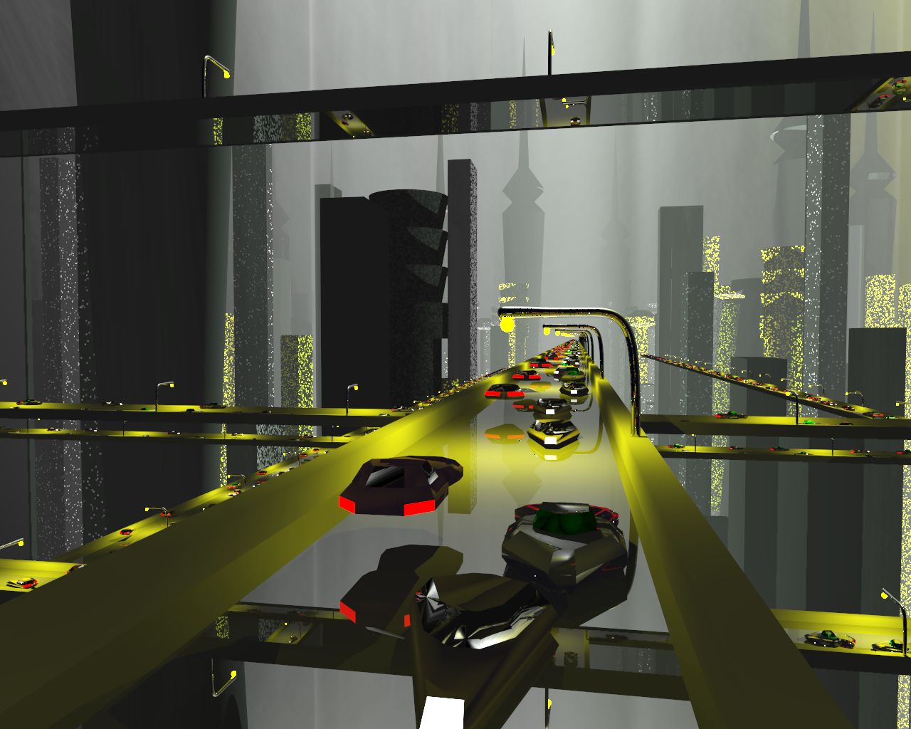

From: Bryan Valencia
Subject: Re: media again (and again)
Date: 20 Apr 2006 10:33:43
Message: <44479bc7@news.povray.org>
getting closer...
"Bryan Valencia" <pov### [at] spamgourmetcom> wrote in message
news:443c3bc4$1@news.povray.org...
>penetrating
> my brain.
> complicate things.
> media.
Download 'megacity3.jpg' (143 KB)
Preview of image 'megacity3.jpg'
