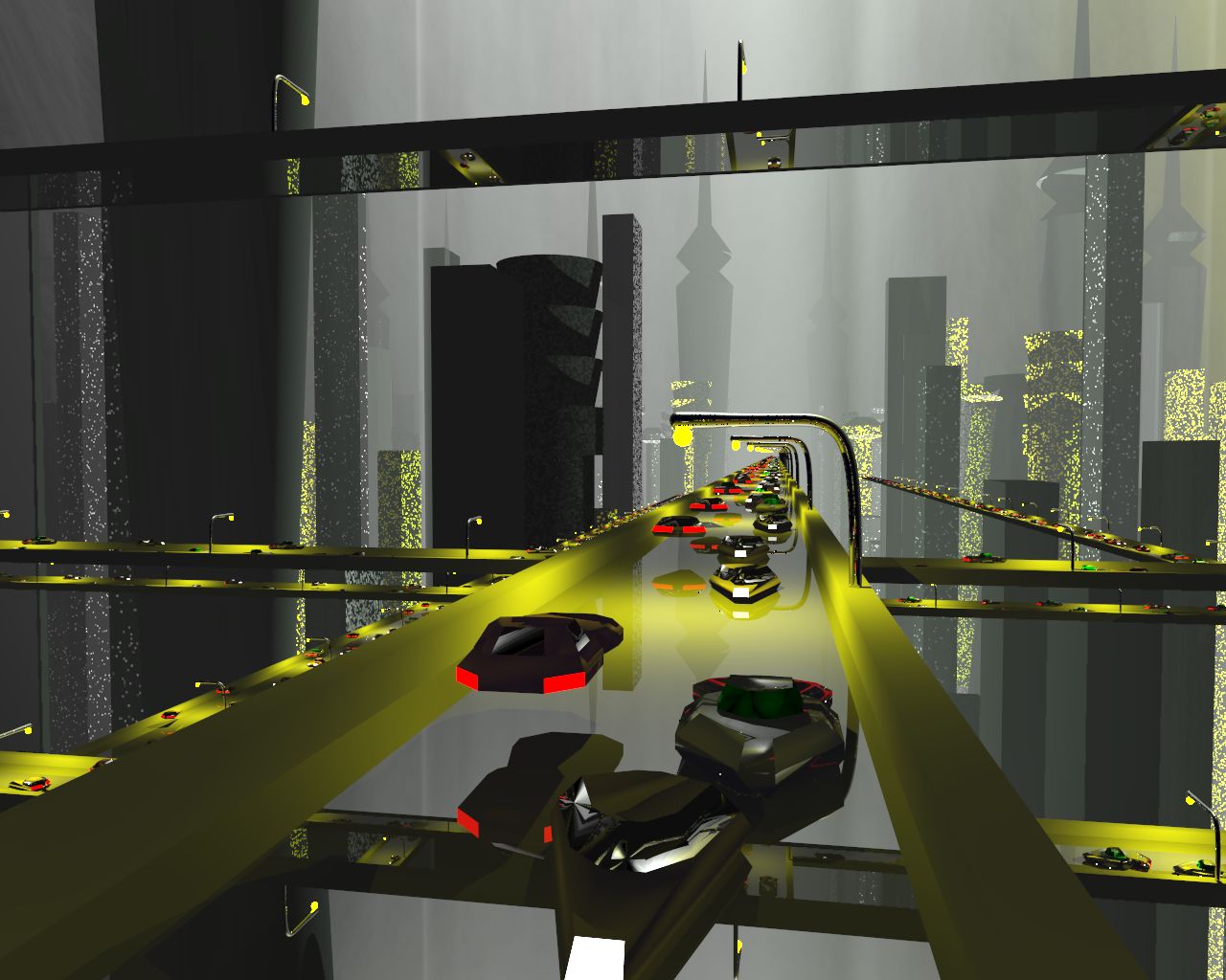

From: Bryan Valencia
Subject: Re: media again (and again)
Date: 20 Apr 2006 10:33:43
Message: <44479bc7@news.povray.org>
getting closer...

Download 'megacity3.jpg' (143 KB)
Preview of image 'megacity3.jpg'
