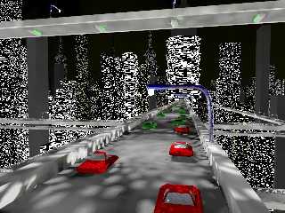

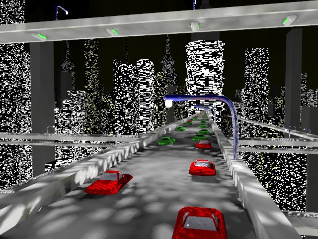

I know I should be able to get this by now, but somehow it's not penetrating
my brain.
I have an outdoor night city scene and I have placed spotlights on the
ground and I want the media to do 2 things.
1. show the light being cast upwards through the city
2. make the distant buildings less clear.
There is a lot of radiosity lighting in this image too, which seems to
complicate things.
Here is the current thing...  I'm using a very big sphere to contain the
media.
Download 'City(rad+media).jpg' (103 KB)
Preview of image 'City(rad+media).jpg'

Try turning off radiosity and working with just the media. Better yet,
make sure you're using the "hollow" keyword on the containing object.

From: Bryan Valencia
Subject: Re: media again (and again)
Date: 12 Apr 2006 08:49:59
Message: <443cf777$1@news.povray.org>
ok, but do you see all those streetlights?  They would have to become
light_sources, wouldn't they?

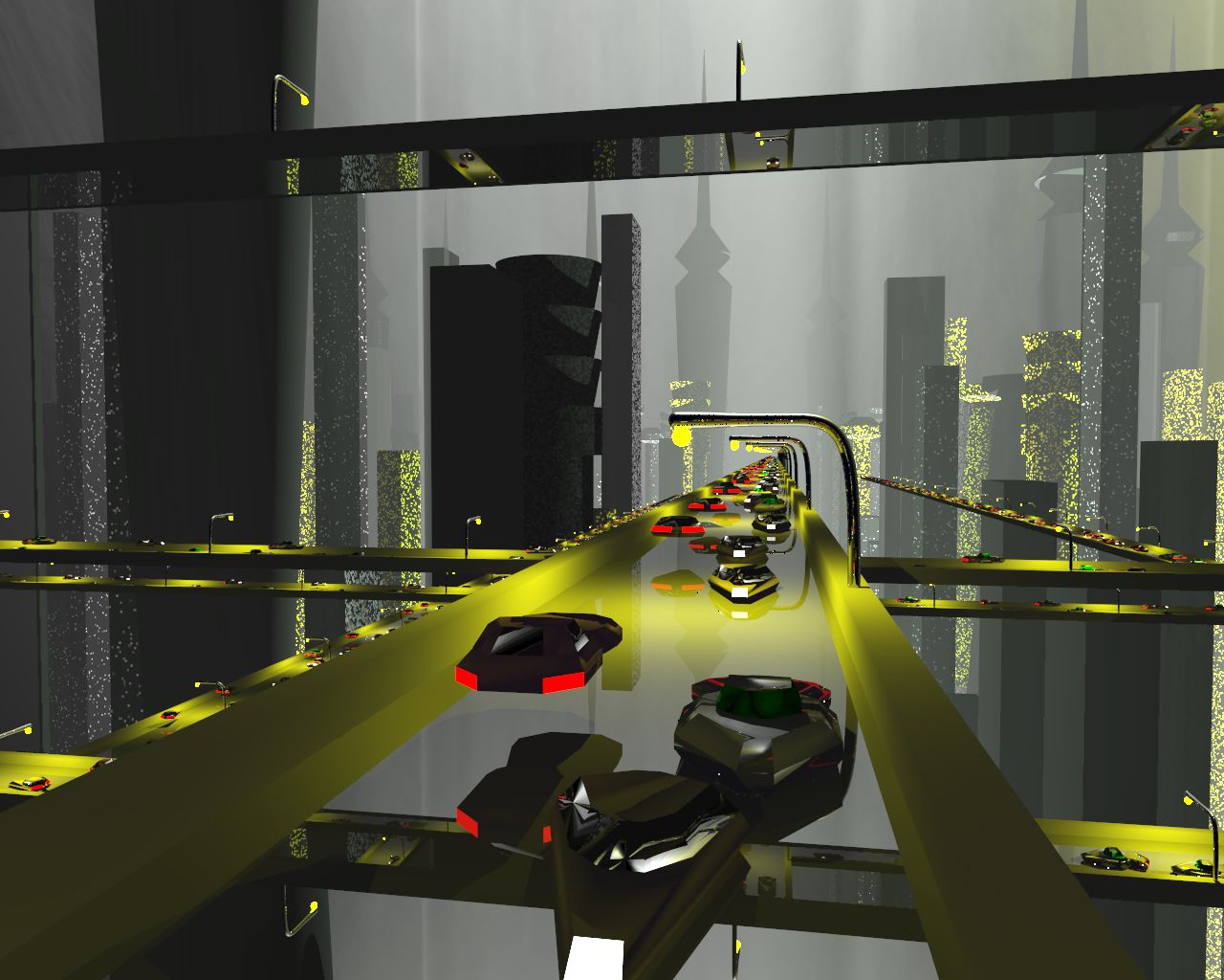

Date: 20 Apr 2006 10:33:43
Message: <44479bc7@news.povray.org>
getting closer...
"Bryan Valencia" <pov### [at] spamgourmetcom> wrote in message
news:443c3bc4$1@news.povray.org...
>penetrating
> my brain.
> complicate things.
> media.
Download 'megacity3.jpg' (143 KB)
Preview of image 'megacity3.jpg'
