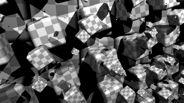

From: Sebastian H
Subject: Re: Problem with f_rounded_box function
Date: 12 Mar 2006 17:15:38
Message: <44149d8a@news.povray.org>
Here's the image of the test scene I used for comparing
the speed of different incarnations of f_rounded_box.
Actually I desired a more ordered scene but a typo ended
in this fractal beauty...
Sebastian
Download 'frb_benchmark.jpg' (44 KB)
Preview of image 'frb_benchmark.jpg'
