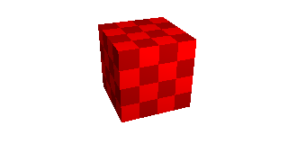

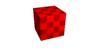

Hello
There seems to be a bug in the f_rounded_box function
when used with a zero radius. The documentation reads
for this case: "Zero gives square corners".
When used in an isosurface this appears to right only if
the bounding box exactly fits the now not more *rounded* box.
But if the bounding box is slightly increase there appears
a broken surface.
The first image shows an isosurface with exactly fitting bounding
box (means contained_by{ box{...} }) whereas the second one
shows the same isosurface with slightly increased bounding box.
The scene file is in p.b.scene-files.
Is this a known problem/bug?
I'm using POV-Ray 3.6.1
linux gcc (GCC) 3.3.5 (Debian 1:3.3.5-13).
Sebastian
Download 'frb_nobug.png' (5 KB) Download 'frb_bug.png' (4 KB)
Preview of image 'frb_nobug.png'
Preview of image 'frb_bug.png'
From: Sebastian H
Subject: Re: Problem with f_rounded_box function
Date: 9 Mar 2006 09:04:12
Message: <441035dc$1@news.povray.org>
Sebastian H. wrote:
> problem/bug?
I dug a bit in the source code and found that a
change in fnintern.cpp fixes the problem.
In the f_rounded_box function there is an offset
of 1e-6 subtracted from the actual result.
return (... - 1e-6);
With an increased offset magnitude of 1e-3
the problem disappears and the isosurface looks correct.
Why this offset is there is beyond me but removing it
slows down the isosurface rendering a lot.
Sebastian

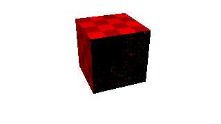

From: Mike Williams
Date: 9 Mar 2006 11:23:46
Message: <PSOA7GAVPFEEFw6T@econym.demon.co.uk>
Wasn't it Sebastian H. who wrote:
>Sebastian H. wrote:
>> problem/bug?
I noticed that the slow down only seems to be happening with the
processing of shadows. If you add the no_shadow keyword, or move both
lights round to the front, then the isosurface renders quickly, but it
still has speckles.
Mike Williams
Date: 9 Mar 2006 11:55:03
Message: <dupme5$rqb$1@chho.imagico.de>
Sebastian H. wrote:
> Sebastian H. wrote:
>> problem/bug?
The docs are wrong, f_rounded_box() should only be used with radius > 0.
  This is not a bug but simply a limitation (although it would of course
make sense to add an efficient handling of the case radius=0).
Note the current f_rounded_box() is not a very efficient solution anyway
(you don't need an sqrt() for every evaluation).
To me it seems this offset is specifically for handling the degenerate
case.  Choosing 1e-3 simply gets you beyond your accuracy limit.
POV-Ray tutorials, include files, Landscape of the week:
http://www.imagico.de/ (Last updated 31 Oct. 2005)
MegaPOV with mechanics simulation: http://megapov.inetart.net/

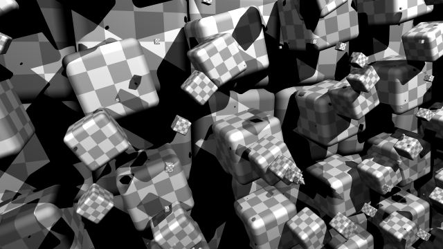

From: Sebastian H
Date: 12 Mar 2006 17:15:38
Message: <44149d8a@news.povray.org>
Here's the image of the test scene I used for comparing
the speed of different incarnations of f_rounded_box.
Actually I desired a more ordered scene but a typo ended
in this fractal beauty...
Sebastian
Download 'frb_benchmark.jpg' (44 KB)
Preview of image 'frb_benchmark.jpg'
Date: 12 Mar 2006 17:35:02
Message: <dv27jm$bsr$1@chho.imagico.de>
>> anyway (you don't need an sqrt() for every evaluation).
> Actually I tried the following expression.
> return (PARAM_X * PARAM_X
>  + PARAM_Y * PARAM_Y
>  + PARAM_Z * PARAM_Z
>  - PARAM(0)*PARAM(0));
That's not what i meant.  You don't need the sqrt() on the faces of the
rounded cube - there a simple plane function is sufficient.
