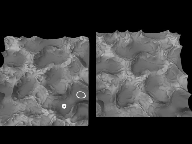

OK. Time for one of my stupid questions.
From one function, I want to render an isosurface as well as a height_field,
following Mike Williams' tutorial. After some trial and error, I obtain the
image posted here. The problem is that the height_field (to the right) is
not centered at exactly the same location as the isosurface (to the left).
And I am unable to find out why, or what I should do about it. I am sure the
answer is ridiculously simple and if a gentle soul could help me in my
darkness, I would be most grateful :-)
I shall post the scene file in p.b.s-f under the same name.
Thanks (many!)
Download 'Iso-HF_test.jpg' (38 KB)
Preview of image 'Iso-HF_test.jpg'

The problematic code is :
isosurface {
   function {y - P(x, 0, 1-z)}
which you can replace with
isosurface {
   function {y - P(x, 0, -z)}
which works fine :-) Amazing what a nasty char can do...
The explanation is that you just want to reverse the z-axis to be
coherent with the height field. By writing  P(x, 0, 1-z) not only do you
reverse the z axis, but you translate it as well...
Hope this helps
Vincent

Here is a general code to illustrate the principle of the conversion HF <->
ISO:
#include "colors.inc"
#include "functions.inc"
global_settings {
  assumed_gamma 1.0
camera {
  location  <0.0, 10, -30.0>
  direction 1.5*z
  right     x*image_width/image_height
  look_at   <0.0, 0.0,  0.0>
background {Gray10}
light_source {
  <0, 0, 0>            // light's position (translated below)
  color rgb <1, 1, 1>  // light's color
  translate <-30, 30, -30>*100
##declare TERRAIN_SIZE = 10;
#declare TERRAIN_HEIGHT = 2;
#declare fn_Terrain = function (x, y, z) {f_agate (x, 0, z)} // Or whatever
in x-z plane. For functions in x-y plane (wood): f_wood(x, z, 0)
#declare O_ISOTerrain = isosurface
    function {y - TERRAIN_HEIGHT*fn_Terrain(x/TERRAIN_SIZE, 0,
z/TERRAIN_SIZE)}
    max_gradient 4
    contained_by {box {<-TERRAIN_SIZE, 0, -TERRAIN_SIZE>, <TERRAIN_SIZE,
TERRAIN_HEIGHT,TERRAIN_SIZE>}}
#declare O_HFTerrain = height_field
    function 300, 300 {fn_Terrain ((x-0.5)*2, 0, -(y-0.5)*2)}
    smooth
    translate -x/2 -z/2
    scale <2*TERRAIN_SIZE,TERRAIN_HEIGHT,2*TERRAIN_SIZE>
// Superimpose the 2 versions to check they are close one to another
object {O_ISOTerrain pigment {Red}}
object {O_HFTerrain pigment {Green}}
     Bruno

Incidentally, your image makes a cool stereoscopic effect if you view it
with your eyes crossed, lining the images up.
 - Slime
 [ http://www.slimeland.com/ ]

oh-oh! A little error in Mike's tutorial, eh? :-)
I shall try this out! Thanks a lot!

Excellent! Many thanks! This should do the job!

Mike's code works OK, and his tutorial is fantastic. It just adresses a
different portion of the pattern (not centered, see mountain4.pov example:
the isosurface is contained_by { box {<0,0,0>, <1,1,1>}}, and not <-1/2,
-1/2, -1/2>, <1/2, 1/2, 1/2>). If you 'recenter' Mike's code, you get the
same.
   Bruno

Oh! Of course! I am just not thinking this through! Too thick a brain case
