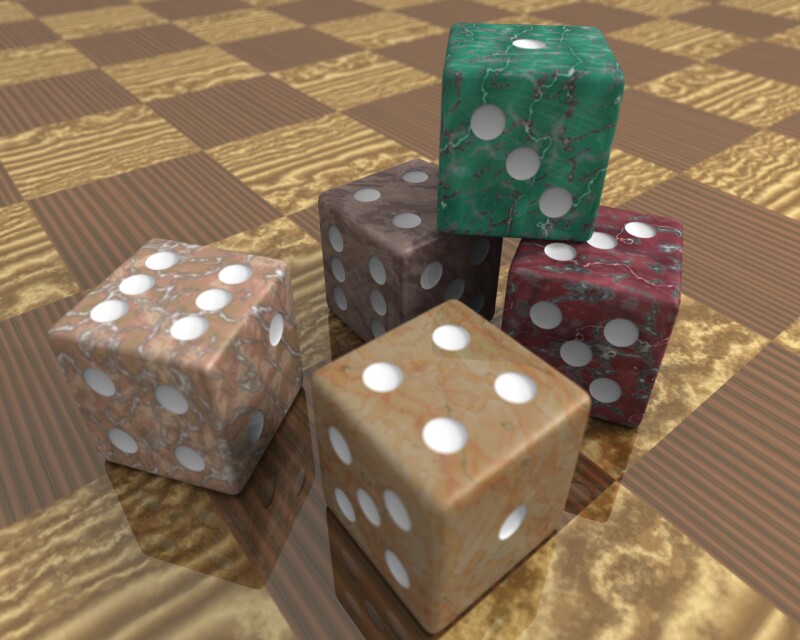

Playing around with radiosity and focal blur. Took about 15 hrs on my
Celeron 2.5GHz laptop. Any suggestions / criticisms?

Looks nice, though small objects made of marble should show some sub-surface
scattering, which would mean using media, which then wouldn't work with
radiosity... Ah what fun :)
My suggestion: switch off radiosity and fake it with multiple light sources,
once you have it looking about the same as this make all the dice
transparent and fill them with dense scattering media with the same pattern
as the pigments they have at the moment. It'll take hours of work and you'll
get an image that is almost identical, but they will feel more like real
marble dice!
Anyway, if you can do it it's worth the effort because sub surface
scattering gives a clue to the size of the object, at the moment they look
really large. Or you could change the material they're made out of to one
that doesn't have significant sub-surface effects (I suggest metal or
glass).
Also if you use a narrower field of view and moved the camera further away
they'll look smaller... and that's gotta be easier than my first suggestion
Tek
http://evilsuperbrain.com

The question you should be asking yourself is : was the blur woth the 15
hours?
If the answer is yes, then good. It is a nice image. Were I to try and fix
the size issue, the only thing I would change is the size of the floor
pattern. Those are pretty tiny checkers, if they are not much bigger than
dice.
Very nice.
-s

Why doesn't media work with radiosity?  Is it just not realistic?  I
know there is a media on tag in the radiosity block, but I must have
missed where the compatibility issues arise.
Skip

No, it doesn't work. The media tag in radiosity is just to tell the
radiosity on the non-media objects to sample from the media. i.e. if you
have a glowing red media next to a white wall you'll get red radiosity on
the wall, but if you have a white scattering media next to a glowing red
wall the media won't pick up any of the red.
It's a matter of the complexity of the problem. With light only coming from
light sources the media needs to trace a shadow ray for every sample point
inside the media, then numerically integrate the samples to work out how
much self-shadowing the media is doing, which in turn requires multiple
samples along the shadow ray, effectively an n^2 complex algorithm (though I
suspect the pov implementation's a little more optimal than that). Anyway,
if you wanted to do that with radiosity you'd need to do these shadow rays
in random directions at every point, and to get a smooth effect you'd need
far more samples than for an opaque object, and I'd guess that the tricks
for smoothing out radiosity on opaque objects don't work nearly as well on
media, so you could be talking about several orders of magnitude more
complexity than just switching radiosity off and using a few extra light
sources.
At least, that's how I think it works.
Still, I'm puzzled that there's no option to do it in POV. Pov's happy to
let me do any of the hundreds of other things that give me infeasibly long
render times :)
Tek

Thanks for that.  Your explanation does awaken some dim and nearly
extinguished memories.
