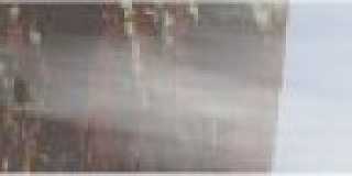

From: POVMAN
Subject: Re: Alien Cliff...again [~150kB]
Date: 3 Feb 2006 08:01:40
Message: <43e35434$1@news.povray.org>
Great Image, I'm soooooooo jealous.
Some thoughts from "Mr Rent-An-Opinion"
The "particles" of the waterfall seem too big near the bottom.  I think the
water need to be more spray-like or more solid.  The water looks like it has
broken up into "lumps".
The Waterfall could do with a mist around its lower half.
The "lens flare" is a little overpowering.
The cloud above the lens flare seems to have small ridges, see the attached
image.
I see that Tim thinks you might add some more colour depth.  I think the
opposite.  The colour level is perfect, to my eyes.

"POVMAN" <s### [at] acom> schreef in bericht news:43e35434$1@news.povray.org...
Thanks!!! No need to be jealous :-) it's just tedious, hard work ;-)
the
has
The waterfall is still an issue. Much better than when I started
implementing, but still... Need much more work. Possibly, spray.inc which I
used for it will not do in the end.
I wonder what I am going to do with it... I am not really satisfied myself.
attached
> image.
Yes, this is a matter of taste. Personally, I am fairly content with the
present colour depth. But I might experiment some more...
