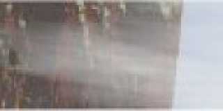

A new version of the Alien Cliff.
Added have been: cloud, waterfall, "birds".
This time, a larger version. Slow rendering (about 36 hours in total)
especially for the lower half of the image.
I am curious about any comments of course!
Download 'Alien Cliff.jpg' (149 KB)
I like where the image is going. I'd look into the colors, it's all very
washed out. Might be the ground-fog... The blue of the sky, the green on the
hills, they could be more saturated.
And how is the image lit, only one lightsources (which obviously isn't the
sun with the flare, wrong shadows for that)? The shadows look very uniform,
so you might either want to add some handplaced fill-lights to simulate
diffuse light (e.g. a reddish lightsource near the cliff, so that objects in
front of it receive reflected light from it), or use radiosity or such. I
generally set ambient to 0 and play with fill-lights & radiosity.
As for that flare, I particularly don't like that it has four spikes. Is it
supposed to be a lense-flare, or just a "too bright to see" spot? In any
case I think the flare should be white, but maybe with a fade to yellow.
When things get too bright, you often just see white.
And 36 hours, sheesh, at was resolution are you rendering? :-) Is it just
because of the isosurface, or is there lot of media in there? If it's
isosurface... Isn't it possible to render a grayscale map from above and use
a heightfield? With various resolutions for foreground and background. The
hills don't have overhangs or such, so I don't think you really need the
slow isosurface there.
Those are all just constructive comments, I hope that wasn't too harsh...
Tim

Can everyone stop posting such good images? I'm having real trouble
paraphrasing my superlatives! ;)
This is excellent, truly amazing. Landscape gardening of the highest order!
I especially like the maze pattern on the balloon, and moving it closer to
the camera means the scale is more apparent.
Two small comments. I think the waterfall needs some spray - it looks too
much like the particle system that it presumably is. Secondly, that bright
yellow lit area to the right, beyond the cliff end - is that deliberate? It
looks fine, I was just curious...
Bring on the final!
Bill

Great Image, I'm soooooooo jealous.
Some thoughts from "Mr Rent-An-Opinion"
The "particles" of the waterfall seem too big near the bottom.  I think the
water need to be more spray-like or more solid.  The water looks like it has
broken up into "lumps".
The Waterfall could do with a mist around its lower half.
The "lens flare" is a little overpowering.
The cloud above the lens flare seems to have small ridges, see the attached
image.
I see that Tim thinks you might add some more colour depth.  I think the
opposite.  The colour level is perfect, to my eyes.

Looks very good... You really got the "huge-ness" factor in there now.
Just one nitpick, I think the lensflare is too big, too there.
Ger

The washed-out look comes mainly from the ground fog. I am not too
displeased with that as it is intentional for the landscape. The cliff for
instance is much sharper / neater than the landscape under some kind of
tropical blanket. But everything can certainly be tweaked more indeed!
uniform,
in
There are three light sources in total: The main sun (outside the view)
generating the shadows; The yellow flare (dimmer) that does not seem to
produce shadows; a fill-in, shadowless light at the spot of the camera, with
a distance fade. Ambient is 0 in the whole scene. Radiosity would be the
next logical step here anyway.
it
Hmm, yes, I know what you mean. I have been hesitating between a lens flare
or a very bright spot. In fact, the second should be it. I have to look into
this...
use
Well, my system is old (win ME; about 6 years old; P3; 1G). I think it is
mainly the plants that slow down the render process, although the landscape
isosurface is slower indeed. But I don't know. I am a bit surprised because
with some 37000 objects, no media, no radiosity, it should be faster... I
shall certainly try the grey scale map as an alternative!
Excellent Tim! You comments make good sense!

LOL! Thanks Bill! I like this scene, but still.... I am not entirely
satisfied...
order!
yes, suddenly in a bright moment, I thought that the balloon needed to be
closer to the camera
It
Yes. You can imagine the time I have already spent on the waterfall (based
on spray.inc by Chris Colefax by the way). I tried different settings, but
it needs more work
The yellow lit area comes from the background height_field. It is in fact
one of the used texture colors. Was not deliberate and is, IMO, too visible.
> Bring on the final!
I will!
> Bill

"POVMAN" <s### [at] acom> schreef in bericht news:43e35434$1@news.povray.org...
Thanks!!! No need to be jealous :-) it's just tedious, hard work ;-)
the
has
The waterfall is still an issue. Much better than when I started
implementing, but still... Need much more work. Possibly, spray.inc which I
used for it will not do in the end.
I wonder what I am going to do with it... I am not really satisfied myself.
attached
> image.
Yes, this is a matter of taste. Personally, I am fairly content with the
present colour depth. But I might experiment some more...
