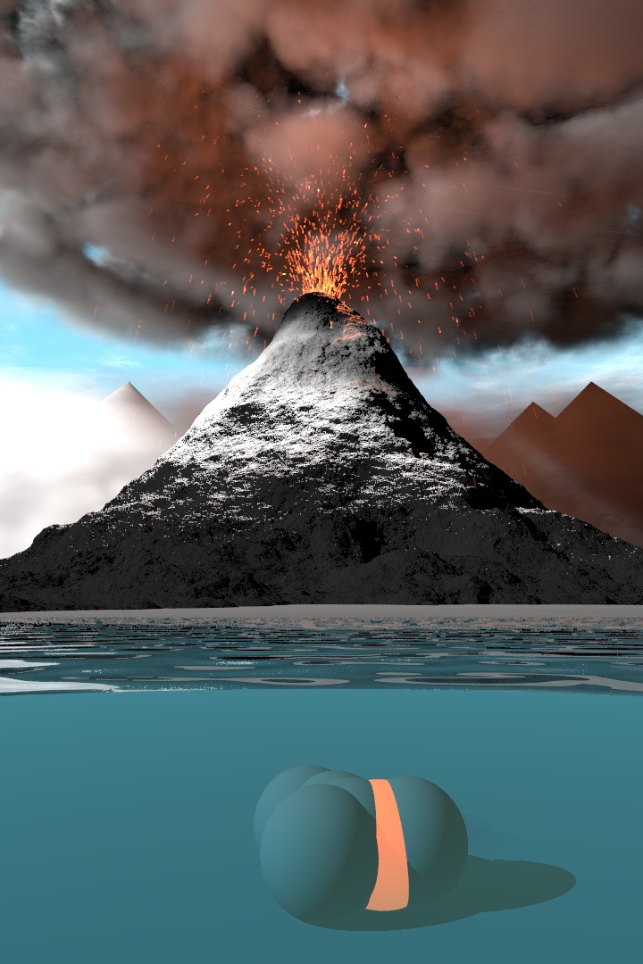

Following my earlier post I've decided to go with the volcano image. This is
the latest version, but I'm suffering a case of povver's block! I can see
the volcano looks bad, but I don't know why. Any suggestions?

It might be because I expect the volcano to loom over me. Even though
I am sure the view is correct. It might be a case of Real Life not
living up to Hollywood Movies.
A bit unsettling but I like it.

To me, the volcano looks too black - it's hard to make out any details
of the surface. My feeling is it should be a bit brighter (or perhaps
just lit better), even if it's made out of lava.
The lava flying out of the top is nice, but my inner view expects the
individual drops to be greater, perhaps even more drop-shaped along
their flying axis.
Looks like it's going to be a great image, though!
I think that *is* hollywood. Volcanos (and mountains in general) are too
big to loom. By the time they're looming, you're standing on them and
they're under you.
Now, volcanos I think don't tend to be quite so vertical, nor quite so
symetric.  There would probably also be outbreaks of lava on the slopes
as well. It does, after all, melt through rock.
The smoke seems very symetrical also. If there were no wind, I'd think
it would be going mostly up, or up then back down in an umbrella-like
shape. Maybe having the smoke going one way and the lava coming down on
the other side would give a nice balance.
I also doubt you'd find snow on the slopes of an active volcano, as it's
not unusual for the ground to be like 3000 degrees six inches down. I
was caught in a rain storm once in Hawaii that came down so hard you
couldn't breathe if you weren't looking at the ground. My feet stayed
dry, because the rain all evaporated somewhere around my knees. This was
at tourist distances from the lava, too, not like I was in there taking
samples. But of course getting rid of the snow would ruin the artistry
of the image, so that's more a nit than anything.
The ground is both too black and too bare. Lava is very shiney, as the
surfaces were all liquid a short time ago and cooled under gravity. It's
mostly brittle and crunchy, like blown glass. Plus it's full of
delicious plant nutrients, so even days after an eruption, you get grass
there, saplings, etc.
The water near the shore looks kind of grey, but I don't know if that's
correct or not. Unless that's supposed to be a beach or something.
I'm looking forward to how you manage the glow of the lava. :-)

The "something look's wrong" feeling is maybe due to the fact, that normaly the
tip of the volcano is blown off if you have such a vivid erruption, leaving a
crater huger then the lava fountain. Also a lava river rinsing from a break at
the top would make it more Hollywood like.
... dave

I'm sure our ideas on what a volcano should look like will differ with what
kind of mountains are nearby.  For me, here are the two I think of first
when I think 'volcano'since they're the neighborhood mountains (climbed
Helens, skied Hood.) They probably won't be much help for lava realism
though.  I agree with Darren about the symetry & verticality.  Hood is
fairly conical but still a lot flatter and irregular than how your mountain
is now.  St Helens apparently was once noted for how symetrical it was
(prior to what it's most famous for - it's 1980 dissappearance of it's
top). :
http://en.wikipedia.org/wiki/Mount_St._Helens
http://en.wikipedia.org/wiki/Mt._Hood
Also, something about the lava (which I associate with places like Hawaii)
rather than ash/steam, and the light color of the water makes me think
'tropical' which is incongrous with the snow. If the snow is due to
elevation I would expect foothills or something to show that the body of
water is a mountain lake or something.   On the other hand,  in response to
Darren, Mt St Helens is an example of an active volcano that does have
snow.
Hmm, anything else... How far away is it?  Maybe some haze?
Charles

I agree with that last idea. I think the volcano lacks a feel of depth
somehow, and a haze could really help. You could play a bit with the
lighting as well, to make the overall shape more perceptible.
There is also something that disturbs me with the texture, but I can't
exactly spot it now... Maybe it's just to sharp ?
Otherwise the cloud looks really impressive already... Last time I
attempted a thing like that I failed miserably ;-) I think you're on the
right path with this one !
Maybe some more snow near the top. Make the lava ejection narower, between 1/4 and 1/2
the diameter
of the top and uncenterer. As it must be a volcano awakening, there can be snow up to
the rim and
inside of the crater, there should be a lot of steam. One or two steam column rising
from somewhere
on the slopes can add much interest.
The background mountains are WAY to conical.
I would expect the water to be mostly dark gray, it reflect mostly the dark ash cloud
and should not
be as blue as it is now. It's colour should comes from what over it and from some
fade_color.
Adding caustics can improve the aquatic effect. I don't think that using photons here
is worth the
effort nor the increased render time.
If you are short on time, I propose that you drop the under water part, or only have
it visible
trough the surface, disturbed by the waves: remove the cutaway in the water.
Catholicism: If shit happens, you deserve it.

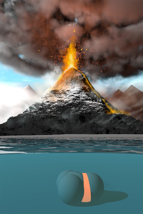

I'm not sure but maybe something like this (Photoshop cheating)
Download 'volcano2.jpg' (88 KB)
> Tek
> http://evilsuperbrain.com
Seeing Mt St. Helens and Mt. Hood every day it's not cloudy and raining
around here, I have a few suggestions, but they may not actually apply.
1) Around here the rock is light gray, and the trees are that dark Fir green
color, but with distance they both turn a medium blue-gray color.  If you
want black basalt for your cone, it may not turn quite as blue, but I
suspect you lose all sense of distance because of that.  The snow should be
a real light blue also.
2) Way too perfect and cone shaped.  The ones around here are rather
deformed, St. Helens looks almost like a ball buried 3/4 down in the ground
from most view points on the south side, but with lots of vert. stripes
where rain has made gullies so there is a rock/snow pattern across it.
Hood still has a peak, but it has a bunch of bumps, canyons, bulges, etc.
from just about any vantage point.  Maybe try pointing Google Earth at some
of the volcanoes you are interested in being similar to.
3) The undersea part still has a ways to go, I think.  At first, I thought
it was a broken open crashed spaceship or something.  Not lumpy enough for
a vent, the water seems to color it too much, but not hide it enough.
Maybe less green for artistry, or more obscure for realism.
Despite all that, It looks pretty good to me, and I'm looking forward to
seeing the final image.
