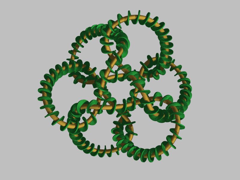

Looking at Bill Pragnell's wonderful trefoil knot work, I wondered if
the same ideas could be generalized to other, more complicated knots by
using splines from KnotPlot, and orienting via Spline_Trace.
The answer seems to be yes and no.  There's evidently some sort of
glitch with v3.6, when it comes to repeated (looped) calls to
Spline_Trace (see the thread in pov.general.)  The attached image was
made with v3.5.  The concern that makes it also not so simple is that
for general splines, they do not cover a fixed curve length per unit
time, so that, by using a simple "while" loop, some parts (of a
stairway, for example) will get crunched together, while other parts
will be stretched out.  I'm puzzling over a macro that will re-divide a
spline to cover curve length at a steady rate (or has this already been
done?)
Also, has anyone else noted the strange behavior of v3.6 and
Spline_Trans?  Is it a known bug? or not a bug?
Dave Matthews
Download 'kp_sample02.jpg' (53 KB)
Preview of image 'kp_sample02.jpg'

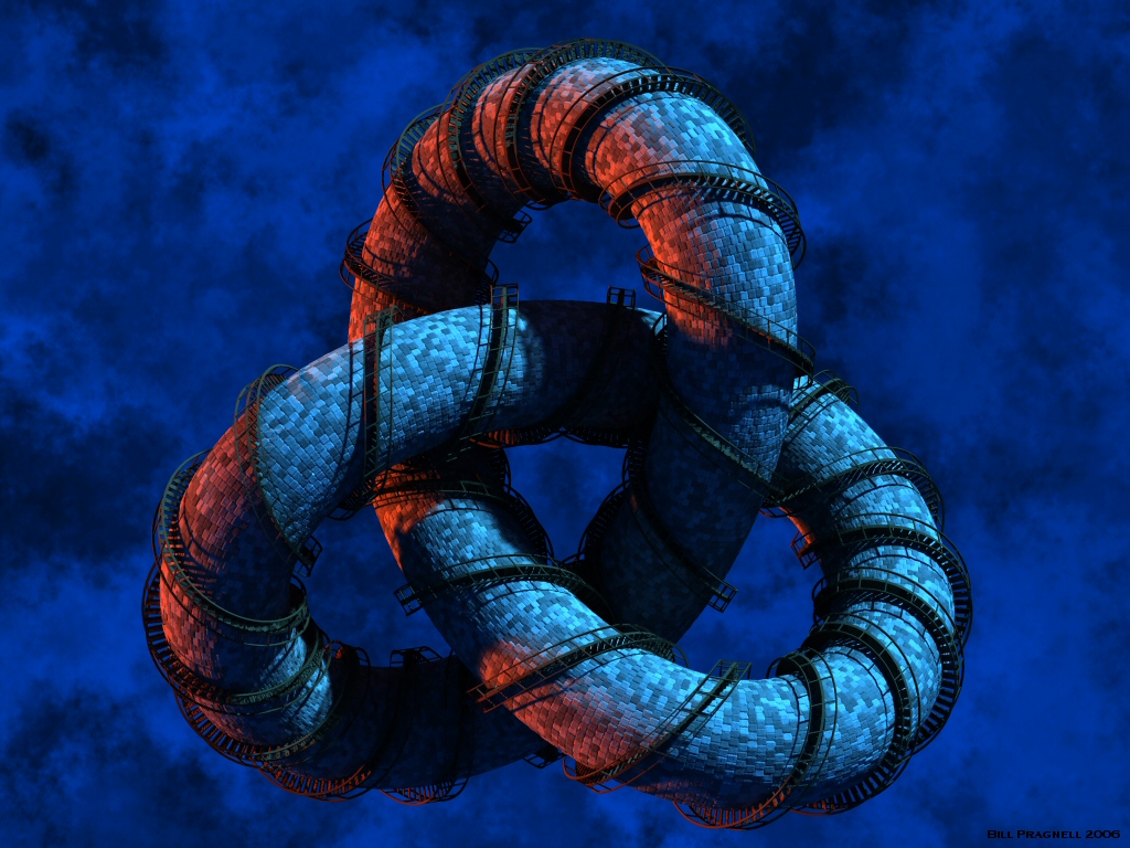

From: Bill Pragnell
Subject: Re: Cheap Imitation and Generalization
Date: 16 Jan 2006 05:10:01
Message: <web.43cb6ff053bbec44731f01d10@news.povray.org>
> done?)
I have done this for the latter instalment of my knot project. My algorithm
is slow (parse time > render time) but seems to do the trick. It entails
slowly moving along the path with very small increments in time, and
numerically integrating the distance travelled using repeated vlength()
calls. When the cumulative distance reaches a threshold, place an object
(in my case, a ring of bricks or a stair), reset the cumulative distance
counter and keep going.
This technique works perfectly, but there is still a small bunching effect
on the inside of steep curves where the ends of wide component objects
describe a shorter path than at the outside (e.g., large gaps between brick
layers on the outside of curves). I've partly solved this problem (for the
bricks, at least) by measuring the distance increment at various points
around the minor radius and scaling the objects accordingly. This too is
not fast :). See attached pic for results.
Bill
PS nice image! I might have to delve into higher-order knots for later
versions...
Download 'trefoil6.jpg' (404 KB)
Preview of image 'trefoil6.jpg'

From: Bill Pragnell
Date: 16 Jan 2006 11:55:00
Message: <web.43cbcf9253bbec44731f01d10@news.povray.org>
"Dave Matthews" <dav### [at] mnwestedu> wrote:
> That was my next concern, also.  The "bunching" would be especially
> noticeable for relatively "thick" knots, like your image.  I suppose for
> the spiral stairway, one solution is to measure the actual length of the
> spiral spline, rather than the center one (?)
But my spiral spline (which I use for the handrails) is already bunched,
because I calculate it using a translate-rotate transform combined with the
central path. In any case, I think the stairs are fine as they are. As long
as they don't turn into a continuous ramp, I quite like the idea of varying
steepness! This is one reason why I've made them simple planks without
risers in the version above. I think it looks quite medieval... :)
I've had a quick look at KnotPlot, but I think it'll be a bit of a haul
learning to use it and then extracting splines. On the other hand, I've
managed to find some examples of more complex knots expressed as parametric
equations - these would be ideal, because I can easily substitute them for
the trefoil in my SDL. All I have to do is increase the step count. This
would be better from an artistic point of view, too - I'd quite like to
have a viewpoint on or close to the stairs, and still have plenty of knot
in view. This would be perfect!
>  I'd really like to see what you could do with other knots
> (maybe whack 'em with a few cannon balls!)
I haven't tried that yet - but I will this week. I shall post anything that
looks good, never fear!
Bill
