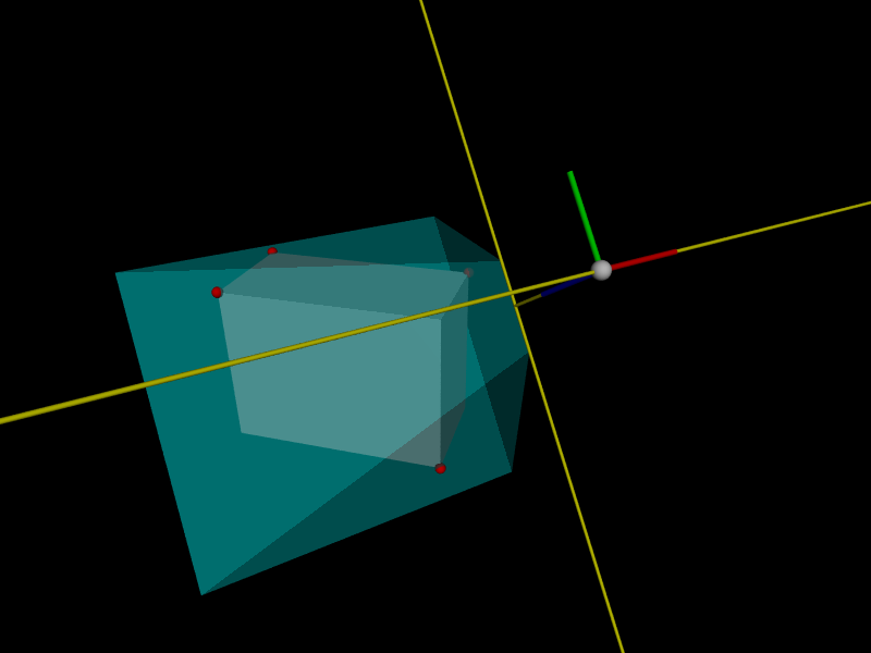

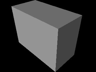

Here are two images showing the results of the script posted on
povray.text.scene-files, solving this problem.
The first one shows the result, that is, a box fitted into view.
The second one illustrates the method, showing the constraints, etc...
explained in greater detail in the script.
