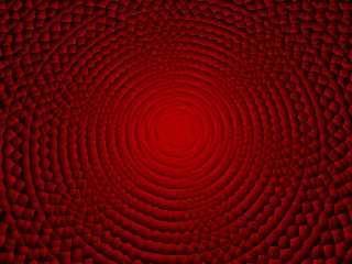

A first try at a spirogram a la Shay.
Total failure, but nonetheless something mildly interesting.
Anybody got code that does nice spirographs? Shay?
I tried implementing the algo at Mathworld, but obviously lacking in the
math department.
Lots of possibilities posed by this - most obvious is a "plekmatjie" in my
language - something that your granny would put the kettle on. Or over the
kettle.
Source in p.b.s.f.
Things to try - bring in some Z, colors, transparency, blobs, and other
objects - a world of possibilities.
Comments welcome or use in your own scenes. From a greater distance makes a
lice little round knitted tea-cosy or something.
Stefan Viljoen
Polar Design Solutions
Download 'spiro2.jpg' (110 KB)
Preview of image 'spiro2.jpg'

Perhaps the problem is your POV rather than your math?
Try keeping track of your last pos and drawing a cylinder between points
instead of all those smushed up spheres!
You may prefer to make an object of the cylinder collection.
i.e. modify your code to look a bit like this.
DLM

From: Stefan Viljoen
Subject: Re: Frist try at...(109KB)
Date: 21 May 2005 02:34:32
Message: <428ed677@news.povray.org>
The right honourable dlm penned on Saturday 21 May 2005 02:36:
> Stefan,
> Ouma would be proud of your doilies!
> DLM
Hey! Suid Afrikaner? Nie gedink daar is nog van ons hier ook nie...! :)
> "Stefan Viljoen" <spa### [at] polardcom> wrote in message
> news:428e330c@news.povray.org...
Thanks for looking - now I just need a kettle.
Lekker bly,
Stefan Viljoen
Date: 21 May 2005 02:38:53
Message: <428ed77c@news.povray.org>
The right honourable dlm penned on Saturday 21 May 2005 03:35:
> Stefan,
> DLM
Thanks I'll try that!
I think I might be misunderstanding how to use sin and cos in pov - them
taking radians an'all. I think I am converting to radians at the wrong
place, mainly due to not figuring out my braces correctly. Just gotta keep
hacking at it.
Have you taken a look at
http://mathworld.wolfram.com/Spirograph.html
That's what I'm trying for - Shay posted some nice pics here a while ago
done with an algo he came up with that implemented those formulae. That
inspired me.
But anyway!
Got another trace running since last night I'll post later - still spheres
but with a bit more color and some Z factored in. Man my new HT CPU kicks
ass for rendering!
Thanks for the suggestion, I'll definitely try those cyls...
Stefan Viljoen

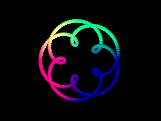

I don't have the education to be educated by mathworld, but it looks (as
best I can tell) like they did the opposite of what I did.
You've got a big cirle of radius RAD that spins around 1 time in one
unit of TIME. So the POSITION on the big circle is:
(multiply by 2*pi to get radians from TIME)
POSITION = <cos(TIME*pi*2) , sin(TIME*pi*2), 0> * RAD;
Then put a smaller wheel whever that wheel is at. Make the small wheel
spin around something like 3.5 SPINS per one unit of TIME:
SMALLPOS = <cos(TIME*pi*2*SPINS) , sin(TIME*pi*2*SPINS), 0> * SMALLRAD;
Add POSITION and SMALLPOSITION together (or subtract, like Mathworld
did), and you're at the point for whatever TIME is on the graph. Connect
several TIME positions together, and you've got a spirograph.
Of course, That formula on Mathworld is just the beginning. <see attached>
   -Shay
Download 'spirograph.jpg' (122 KB)
Preview of image 'spirograph.jpg'
