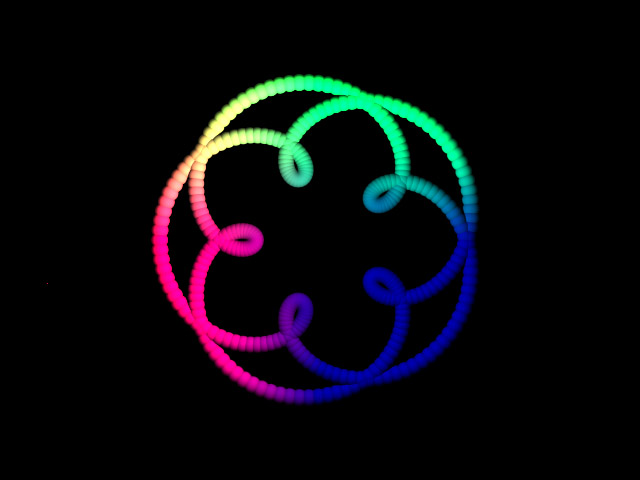

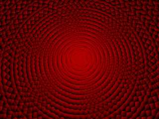

A first try at a spirogram a la Shay.
Total failure, but nonetheless something mildly interesting.
Anybody got code that does nice spirographs? Shay?
I tried implementing the algo at Mathworld, but obviously lacking in the
math department.
Lots of possibilities posed by this - most obvious is a "plekmatjie" in my
language - something that your granny would put the kettle on. Or over the
kettle.
Source in p.b.s.f.
Things to try - bring in some Z, colors, transparency, blobs, and other
objects - a world of possibilities.
Comments welcome or use in your own scenes. From a greater distance makes a
lice little round knitted tea-cosy or something.
Stefan Viljoen

From: dlm
Subject: Re: Frist try at...(109KB)
Date: 20 May 2005 20:34:02
Message: <428e81fa$1@news.povray.org>
Stefan,
Ouma would be proud of your doilies!

From: dlm
Date: 20 May 2005 21:33:27
Message: <428e8fe7@news.povray.org>
Stefan,
Perhaps the problem is your POV rather than your math?
Try keeping track of your last pos and drawing a cylinder between points
instead of all those smushed up spheres!
You may prefer to make an object of the cylinder collection.
i.e. modify your code to look a bit like this.
DLM
#declare radius_fixed = 1;
#declare radius_rotating = 4;
#declare spiro_offset = 1;
#declare my_degrees = 0.0;
#declare x_loc =0;
#declare y_loc =0;
#declare x_loc_o =0;
#declare y_loc_o =0;
#declare z_loc = 0;
//#declare z_fac = 0.0025;
#while (my_degrees < 360)
  #declare x_loc_o =x_loc;
  #declare x_loc = (radius_fixed + radius_rotating) * cos(my_degrees /
57.3) -
  (radius_rotating + spiro_offset) * cos((((radius_fixed + radius_rotating)
  radius_rotating)) * (my_degrees /*/ 57.3*/));
  #declare y_loc_o =y_loc ;
  #declare y_loc = (radius_fixed + radius_rotating) * sin(my_degrees /
57.3) -
  (radius_rotating + spiro_offset) * sin((((radius_fixed + radius_rotating)
  cylinder {
    <x_loc_o,y_loc_o,z_loc>,<x_loc,y_loc,z_loc>,0.025  //0.25
    material {
      texture {
        pigment {
          color Red

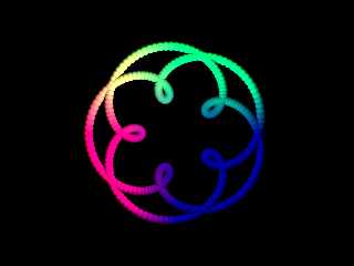

From: Shay
Date: 21 May 2005 11:57:43
Message: <428f5a77@news.povray.org>
I don't have the education to be educated by mathworld, but it looks (as
best I can tell) like they did the opposite of what I did.
You've got a big cirle of radius RAD that spins around 1 time in one
unit of TIME. So the POSITION on the big circle is:
(multiply by 2*pi to get radians from TIME)
POSITION = <cos(TIME*pi*2) , sin(TIME*pi*2), 0> * RAD;
Then put a smaller wheel whever that wheel is at. Make the small wheel
spin around something like 3.5 SPINS per one unit of TIME:
SMALLPOS = <cos(TIME*pi*2*SPINS) , sin(TIME*pi*2*SPINS), 0> * SMALLRAD;
Add POSITION and SMALLPOSITION together (or subtract, like Mathworld
did), and you're at the point for whatever TIME is on the graph. Connect
several TIME positions together, and you've got a spirograph.
Of course, That formula on Mathworld is just the beginning. <see attached>
   -Shay

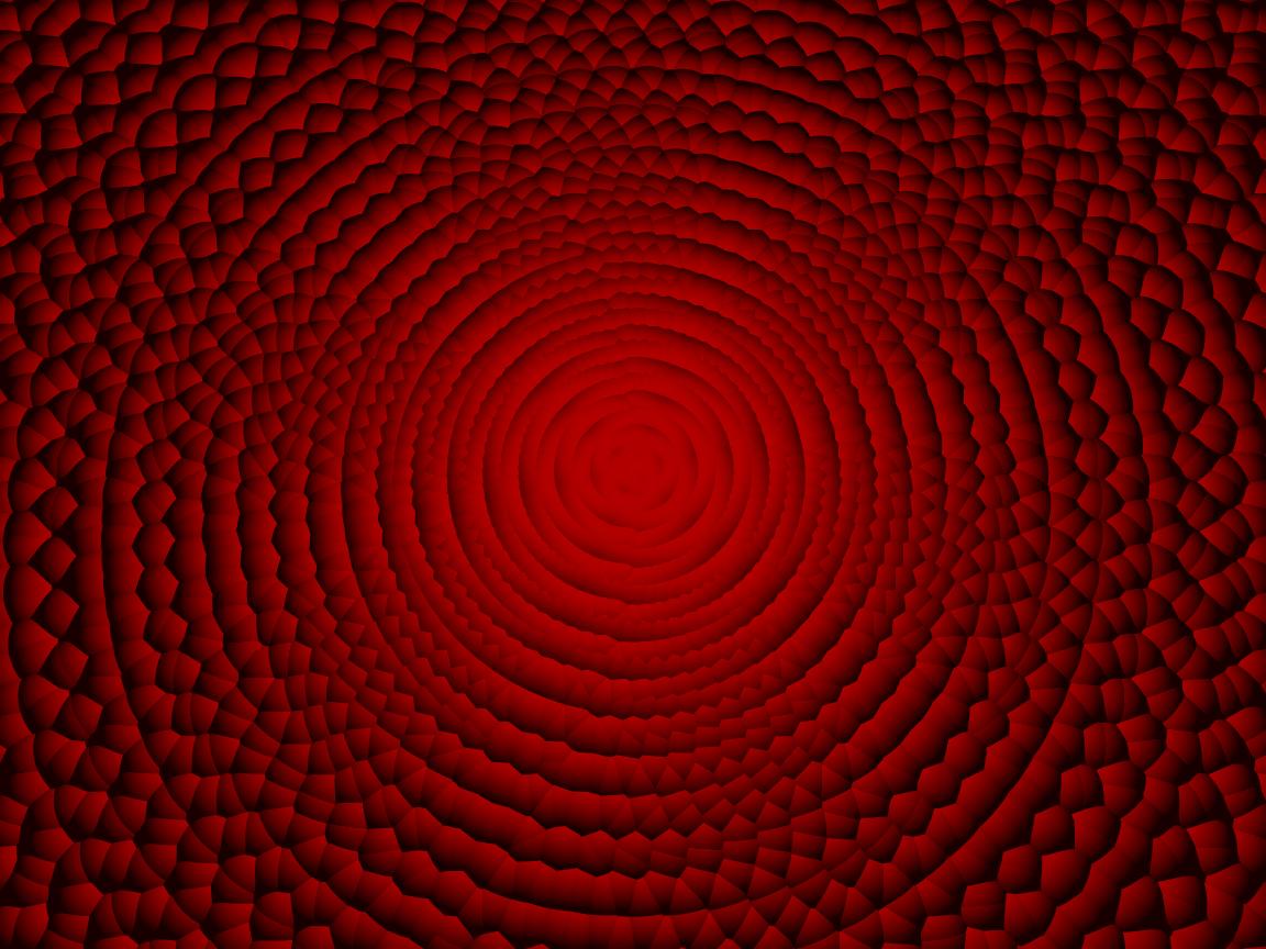

From: dlm
Date: 21 May 2005 16:28:27
Message: <428f99eb@news.povray.org>
"Stefan Viljoen >polard.com>" <spamnot@<<removethis> wrote in message
news:428ed677@news.povray.org...
> The right honourable dlm penned on Saturday 21 May 2005 02:36:
>> Stefan,
>> DLM
> Hey! Suid Afrikaner? Nie gedink daar is nog van ons hier ook nie...! :)
Ek is nie daar nie - VSA toe.
And here's a refinement of your original - see source in p.b.s-f
Currently a kind of tiedied kasteel doily motif.
Play with the parameters.
Best...
DLM
