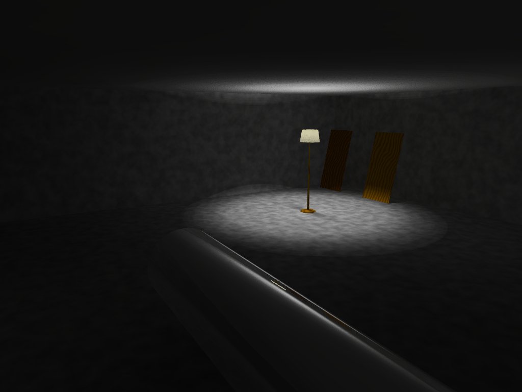

Just a little something I'm working on...
How do I make it so that the room is lit up in the yellowish glow
filtering through the yellow lamp shade?
Download 'radroom1.jpeg.jpg' (34 KB)
Preview of image 'radroom1.jpeg.jpg'
Radiosity.. but you'll need a really high count to get good results
since the shade is so small compared to the rest of the scene.
If you want to cheat, add a second light_source (dim yellow, natch) in
the same place as the first one, but use projected_though to make it
only shine through the lampshade.. at least, I think that'll work. I
expect you'll want to use the same area light settings as for your
primary light_source.
-Xplo
Well, what technique are you currently using for the lighting? You probably
have to use "filter" on the shade and maybe make the lightsource a little
stronger that it stills shows after getting filtered. I tend to exagherate
things first to get the correct effect, and then tweak the values to a
realistic output.

If you want to light up only the walls in yellowish:
Check if the light source has a yellowish color and
check that in the finish of thee walls and floor "metallic" is set in the
reflection {} item.
If the air should be lit, you will need the media statement.
Is this what you meant ?
> realistic output.
Is it filter or transmit? I can *never* remember which is which... :-(
As you probably know, the shade is currently double illuminated, and the
light is an area light. (The scene also uses radiosity; it looks wrong
without it.)
Anyway, I'll give at a go and see what happens...
