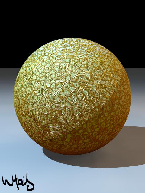

I've tweaked a couple of parameters from the code posted, to give
a better idea of what I'm aiming at, but the texture is structurally
identical.
Total Time:    1 hours 34 minutes 44 seconds (5684 seconds)
but with normal off in the radiosity block (not posted):
Total Time:    0 hours  1 minutes 48 seconds (108 seconds)
The result's not that different, I guess I could live with it, but
I'm still interested in any suggestions.
Bill Hails
http://thyme.homelinux.net/
Download 'test-rad.jpg' (50 KB)
Preview of image 'test-rad.jpg'
Radiosity normal calculation is slow. Maybe you can use a shadowless light
(maybe even in a light_group with the object that needs shadowed lighting)
instead?
Aside: considering how slow radiosity normal calculation is, it would be
nice if one could turn it on for an individul object and not the whole scene
at once.
 - Slime
