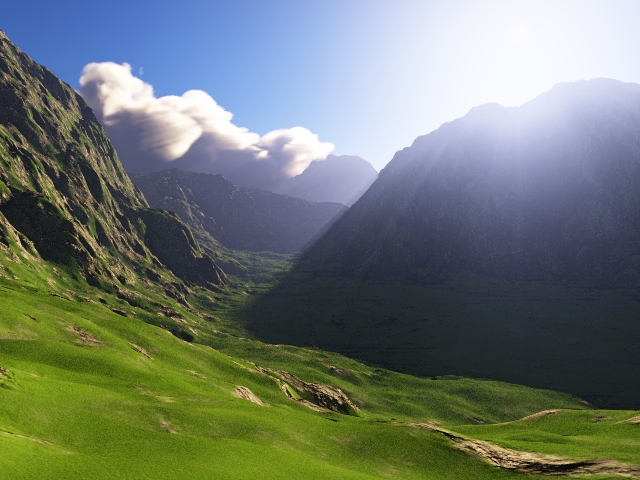

...a kind of fantasy landscape where everything is covered with a
variety of uniform astro-turf-like moss.
The main objective here was to get a sort of "mimic terrain" effect,
like Terragen's, going with the surface roughness (normals). There is
also some distance based fall off on the intensity of the normal pattern
to reduce the grainy appearance of large bump_size at points farther
away on the height field. Atmosphere is media.
Borrowed the cloud (df3) from Gilles Tran and pinched some radiosity
settings from Jaime Vives Piqueres.
Abe
Download 'landscape04-24-05.jpg' (212 KB)
Preview of image 'landscape04-24-05.jpg'
> Abe
Lovely.
Dunno about fantasy though, it could easily be New Zealand.
Bill Hails
http://thyme.homelinux.net/

> Lovely.
Agreed.
...and *where* was LotR filmed? ;-)

Brilliant :D
Render time?
Stefan

I love it!
What about some (more) technical info?   :-)

Beautiful

I really like the way the grass is broken up by rocks. Looks very natural.
I'd love to see a slow, cold river at the foot of that mountain, with
pebbled shorelines though, it would look very refreshing.
-r

"Stefan Persson" <azy### [at] hotmailcom> wrote:
> Brilliant :D
> Render time?
About 00:50:00 on at 2.3GHz. I was kind of suprised that it was not any
longer what with radiosity, media, and several layers of functions for the
normals. :)
Abe

> I love it!
> Thomas
Ooof! I was afraid somebody would ask.
The scene structure was not quite as clean and robust as I wanted it. That
is, when I plugged in a different height field later I found that I did not
quite have the control over appearance which I had hoped for. However, the
rough outline is as follows:
Lighting: Used an area light for the landscape and a point light for media
(atmosphere and cloud illumination). Pre-calculated the radiosity data for
a faster render.
Atmosphere: Three independent media containers (ala mediasky.pov with
minimum altitude set to zero). 1)Blue scattering and red absorption:
(extinction set to zero and replaced with an explicit absorption media for
better control over color). 2)Haze: White isotropic scattering for
atmosphere "thickness". 3)Sun glow: strongly forward scattering media.
Cloud: as previously described. Needed to be set behind the atmosphere
"shell" in order to avoid media container artifacts and also to get decent
shadow color (i.e. not gray). In my opinion the most successful CG clouds
are those that acknowledge color not only in the (directly) illuminated
regions but also in the shadows. Furthermore, there is often a color
variation with distance due to atmospheric effects. Fluffy white (rgb
<1,1,1> and gray rgb <.3,.3,.3> clouds in a blue (rgb <0,0,.75>) sky only
have limited appeal. That said, I'm probably as guilty as anybody, for
rendering aesthetically challenged clouds. :)
Terrain: 1024 square height_field. I used a procedural texture to try to
distinguish the rough areas from the smooth in the terrain. This is
actually what the main point of the scene was. Since steeper slope does not
exactly equal rougher terrain, I was trying for some other measurable
criteria, including 2nd derivative of the gradient, local difference in
gradient as calculated with two different point spacings, and sample point
difference from the surrounding local average. I think I used the second
method in this instance. I have not really nailed this down yet, and
sometimes I am not even sure I _really_ know what I am doing!
As far a camera placement and view orientation I used Terragen as a preview
tool (very practical) and translated the parameters to POV.
I hope this answers some questions. Sorry for the lack of any actual code.
Abe

Ys, it does. It is always interesting to try to understand how an image was
built up. Very helpful, thanks a lot!
