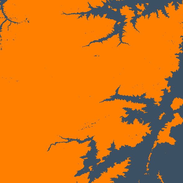

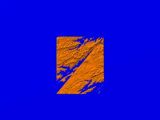

But the result was weird, obviously the float values in the ASCII matrix
are arranged in a different way than the pixels in the GEO-TIFF file.
Attached are the mesh2 rendering and an 2D map generated with 3DEM
showing how the terrain should look instead.
For better comparability of the land features, I placed a waterline at
2500 metres elevation in both images.
The code is available on p.b.s-f
See you in Khyberspace!
Yadgar
Download 'iotest-n.png' (67 KB) Download 'n34e068.jpg' (38 KB)
Preview of image 'iotest-n.png'
Preview of image 'n34e068.jpg'

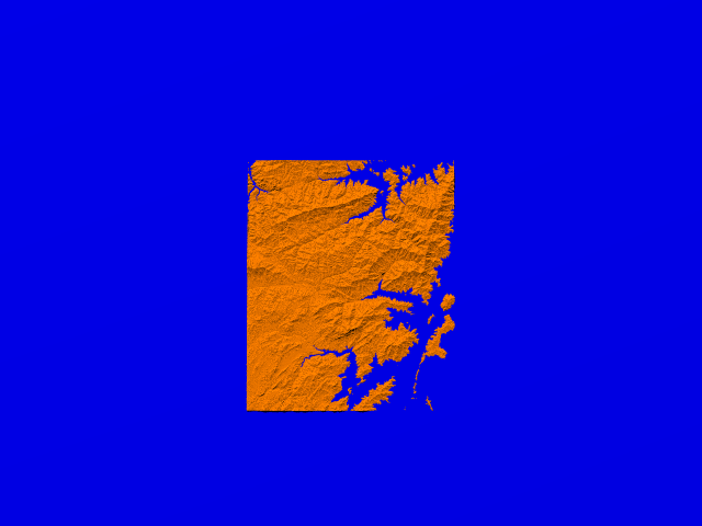

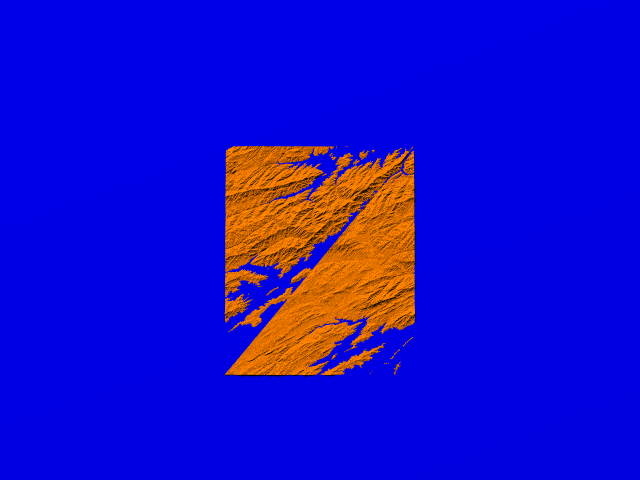

High!
Shortly after my last post, I looked up the corresponding thread on
p.b.s-f and found a post of J. M. Berger where he pointed out an error
in his correction of my original traditional mesh version.
So I replaced all "data" in the vertices block by mtrix[a][b] - and this
is what I*ve got (again compared to the 2D map from 3DEM - code (now
really) on p.b.s-f):
Yadgar
Now playing: Village (Robert Quine & Fred Meer)
Download 'iotest-n.png' (91 KB) Download 'n34e068.jpg' (38 KB)

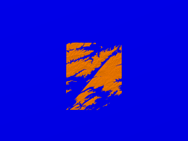

andrel wrote:
> One pixel, because the matrix is square and there is a diagonal.
> Assuming he is reading left to right and top to bottom, Yadgar
> is reading one to little per line. A typical obi-wan error I guess
> (http://www.catb.org/~esr/jargon/html/O/obi-wan-error.html).
Yes, that's it... how on Earth could I know that the ASCII matrix is in
fact 1201 by 1201? I once again tried it with 1201 instead of 1200, and,
finally got it right (attached here)!
But the GeoTIFF conversion tools mentioned before by Christoph is VERY
intriguing... I think I'll try it out somewhat later, when I finished
the first ground views for better judgement!
Yadgar
Now playing: Earth (Adalbert von Deyen)
Download 'iotest-n.png' (85 KB)
