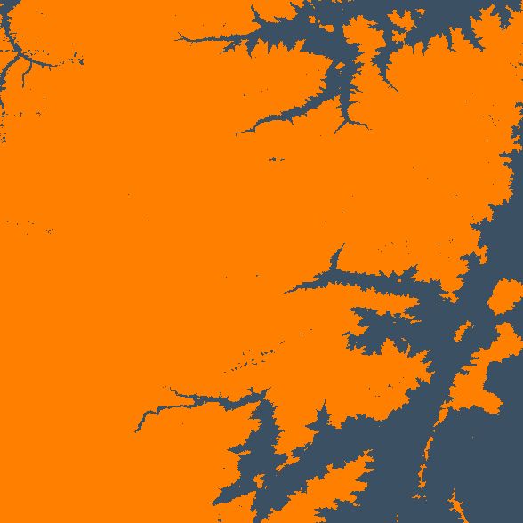

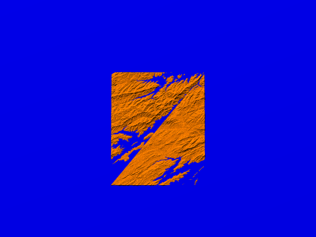

But the result was weird, obviously the float values in the ASCII matrix
are arranged in a different way than the pixels in the GEO-TIFF file.
Attached are the mesh2 rendering and an 2D map generated with 3DEM
showing how the terrain should look instead.
For better comparability of the land features, I placed a waterline at
2500 metres elevation in both images.
The code is available on p.b.s-f
See you in Khyberspace!
Yadgar
Download 'iotest-n.png' (67 KB) Download 'n34e068.jpg' (38 KB)
Preview of image 'iotest-n.png'
Preview of image 'n34e068.jpg'

> As I did not (yet) found any understandable definition of the GeoTIFF
> standard, I had to content myself with converting them into ASCII
> matrizes with a vertical resolution of 1 metre.
Oh, come on, there is GDAL: http://www.remotesensing.org/gdal/ which
comes with a simple utility program that converts between any formats
supported which includes Geotiff of course as well as PNG and PGM which
can be read by POV-Ray.
You quite obviously got the size of the images wrong by 1-2 pixel.

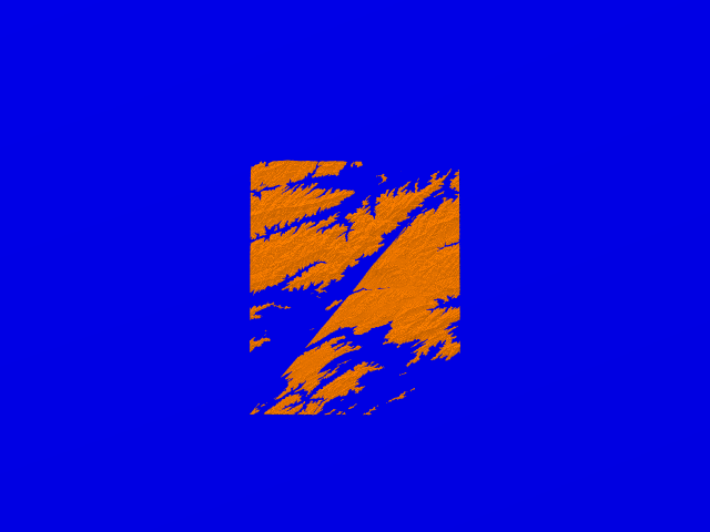

From: Jörg 'Yadgar' Bleimann
Subject: Re: Problem with ASCII matrix read into a mesh2
Date: 2 Apr 2005 07:31:15
Message: <424e9093@news.povray.org>
High!
Shortly after my last post, I looked up the corresponding thread on
p.b.s-f and found a post of J. M. Berger where he pointed out an error
in his correction of my original traditional mesh version.
So I replaced all "data" in the vertices block by mtrix[a][b] - and this
is what I*ve got (again compared to the 2D map from 3DEM - code (now
really) on p.b.s-f):
Yadgar
Now playing: Village (Robert Quine & Fred Meer)
Download 'iotest-n.png' (91 KB) Download 'n34e068.jpg' (38 KB)
>> matrix are arranged in a different way than the pixels in the GEO-TIFF
>> file.
One pixel, because the matrix is square and there is a diagonal.
Assuming he is reading left to right and top to bottom, Yadgar
is reading one to little per line. A typical obi-wan error I guess
(http://www.catb.org/~esr/jargon/html/O/obi-wan-error.html).
Now playing: New Deal by Dolores Keane
Date: 2 Apr 2005 10:14:19
Message: <424eb6cb@news.povray.org>
I never heard of this! So, possibly the detour via the ASCII matrix is
not longer necessary?
Yes, otherwise there wouldn't be that strange diagonal scarp... must be
a mistake in J. M. Bergers correction of my original version (using a
traditional mesh rather than mesh2). I'll soon try it out (the indices
obviously must be set to 1200 x 1200 x 2, not 1199 x 1199 x 2!), but
firstly, I have to complete the download of the current Java API ;-)!
Yadgar

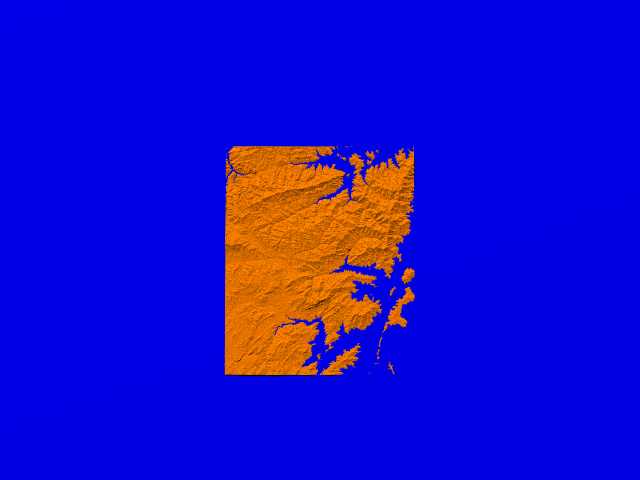

Yes, that's it... how on Earth could I know that the ASCII matrix is in
fact 1201 by 1201? I once again tried it with 1201 instead of 1200, and,
finally got it right (attached here)!
But the GeoTIFF conversion tools mentioned before by Christoph is VERY
intriguing... I think I'll try it out somewhat later, when I finished
the first ground views for better judgement!
Yadgar
Now playing: Earth (Adalbert von Deyen)
Download 'iotest-n.png' (85 KB)

From: andrel
Date: 2 Apr 2005 14:22:12
Message: <424EF05D.7020805@hotmail.com>
> fact 1201 by 1201?
1) counting ;)
2) it is not uncommon to add one extra line to make sure that
  interpolation can be performed without having to read the
  surrounding tiles.
3) look at the result and you can easily spot what is wrong
