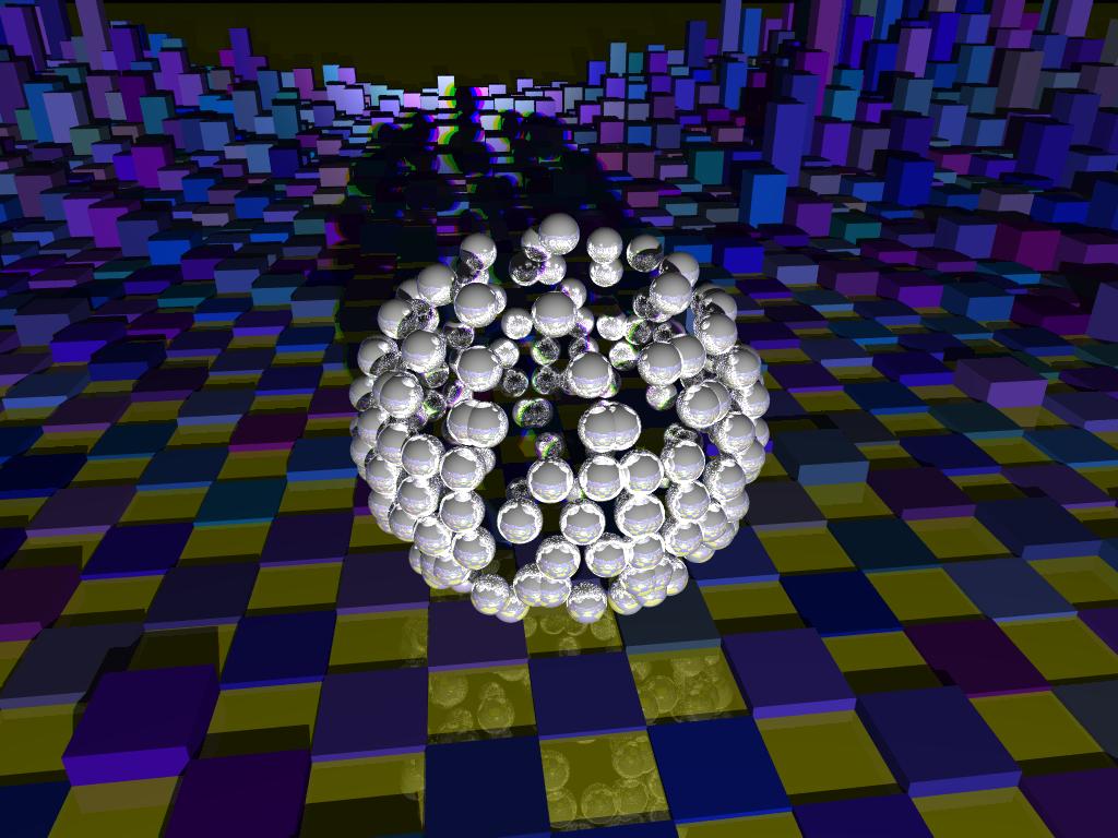

It is said somewhere that every beginner must do a reflecting sphere on a
checker.
So, I'm a beginner, and...
I wanted to be more creative than only copying a single scee everybody
already did, I hope you'll like the result.

Ah ! I forgot : the source...

Subject: Re: my sphere on checker...
Date: 9 Mar 2005 14:20:24
Message: <422f4c78$1@news.povray.org>
I like this a lot. Has a kind of 'order from chaos' look to it. Nice work on
your first posting, and thanks much for including the scene script.
If you were to make any changes to this I will suggest having the spheres
not interact with each other. You could find many postings about such a
thing if you don't know how to go about it yourself.
Although, as it currently is, I think the merging of spheroids and no
overlap of "cases" balances the image out, in that the sphere is amorphous
and boxes crystalline in appearance. So that is actually a good thing,
probably.

Thanks for your advices.
By the way, I understood my error : cos and sin function work in radian, not
in degrees.
Modifying this in my script gives something much better, without any
intersections.
I made tries with blobs. Must do more tries. Don't master blobs yet. Lots to
learn. I love this program...

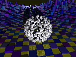

Wrapping the sin() and cos() functions like degrees(cos(radians( foo )))
blew the sphere spheres so far out they became stars. :-)
I just figured out while loops though, maybe its beyond me for the moment.
Heres an animgif of my fixing attempt. (no intersections though!)
Download 'sphereonchecker.gif' (80 KB)
Preview of image 'sphereonchecker.gif'

Try just cos(radian(foo)), without the degree.
After you took the cosinus, you don't obtain an angle so you don't have to
convert back in degree.
Easier, in the script, replace "pas = 360/nombre" with "pas=2*pi/nombre"
