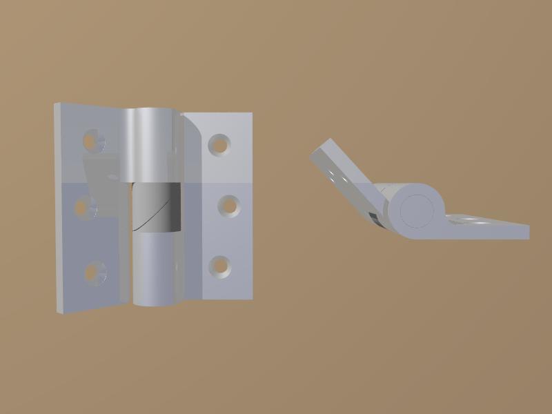

I would like to add the cam part to my hinge. A ramp that wraps around the
pin. I'm thinking that a cylinder isosurface whose height changes with the
angle should work. Looking up the parts on f_ph and f_th don't seem to help
me understand them any better. I can get a cylinder but the change in height
is giving me a head ache. Some help would be appreciated :-)
Stephen

Download 'hinge_camlift.jpg' (8 KB)
Preview of image 'hinge_camlift.jpg'

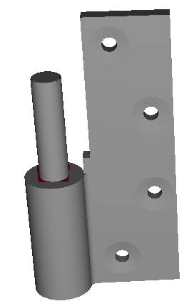

G'day Stephen,
I went to the toilet downstairs earlier and noticed it had the sort of
hinges you're trying to do. The slope you're searching for is just a
flat plane. No need for twist or anything, just a cylinder minus a plane.
I've attached a scene of the hinge I've written. Code is below.
Animation is in p.b.a (if I can work out how to make it small enough)
The ClosingHinge() macro takes three parameters:
	Scale
		-- Really should remove as it can be done elsewhere
	DoorAngle
		-- The angle at which the door is CURRENTLY
		   0   = hinge is flat
		   180 = hinge is folded completely
	PreferredAngle
		-- The angle at which the door would sit if let to swing
Cheers!

Download 'closinghinge.jpg' (14 KB)
Preview of image 'closinghinge.jpg'

Mike Williams
Gentleman of Leisure
From: Rick Measham
Subject: Re: Isosurface cylindrical ramp?, cam lift hinge
Date: 7 Mar 2005 02:46:56
Message: <422C06F5.30201@nomail>
Mike Williams wrote:
> I don't think that works at all well. When the hinge is part open, the
> whole weight of the door is supported on a single point of contact, and
> that's going to damage the hinge. Here's a close-up of just the contact
> surfaces showing the problem.
Just ran downstairs to check .. only thing I got wrong is the angle.
Probably closer to 30 than the 45 I put in there. The hinge does indeed
rest on on that small point.
The plastic part of the hinge is a fairly strong plastic that's not
going to break too soon as this building is 10+ years old .. and I've
never seen one of these hinges broken anywhere.

From: StephenS
Date: 7 Mar 2005 06:28:42
Message: <422c3aea@news.povray.org>
> Here's something that might get you started.
> Mike Williams
That indeed helped. Will look into the second example as time permits.
Stephen
