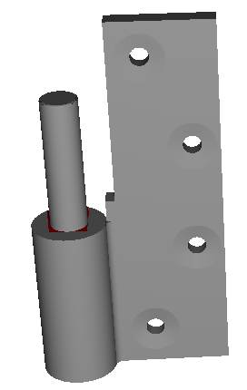

I would like to add the cam part to my hinge. A ramp that wraps around the
pin. I'm thinking that a cylinder isosurface whose height changes with the
angle should work. Looking up the parts on f_ph and f_th don't seem to help
me understand them any better. I can get a cylinder but the change in height
is giving me a head ache. Some help would be appreciated :-)
Stephen

From: Mike Williams
Subject: Re: Isosurface cylindrical ramp?, cam lift hinge
Date: 6 Mar 2005 23:24:57
Message: <eqXElEAJe9KCFwzQ@econym.demon.co.uk>
>Stephen
Here's something that might get you started. I had to swap the axes to
y-upwards because my POV intuition doesn't work in z-upwards mode.
A big problem is that the gradient becomes infinite at the vertical
edge, which means that it takes a nearly infinite amount of time to
render with eval, and doesn't render correctly with any finite value of
max_gradient.
I tried rendering it with a low max_gradient and masking the dodgy edge
with a thin box. That helped, but there are still some bad bits that are
still visible unless I make the box so large that it becomes noticeable.

From: Mike Williams
Date: 6 Mar 2005 23:47:49
Message: <yqeP1CAtz9KCFwWq@econym.demon.co.uk>
>>Stephen
Here's a version that doesn't have the problem of infinite gradients.
I've split the isosurface into two parts each of which POV considers to
have finite gradients. The actual gradients that it thinks it finds are
still a bit weird because the edges are still pathological, so you'll
get warnings suggesting max_gradient values that vary considerably.

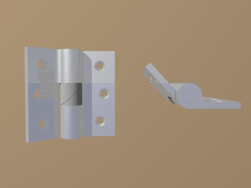

From: Rick Measham
Date: 7 Mar 2005 02:16:15
Message: <422BFFC3.1090804@nomail>
G'day Stephen,
I went to the toilet downstairs earlier and noticed it had the sort of
hinges you're trying to do. The slope you're searching for is just a
flat plane. No need for twist or anything, just a cylinder minus a plane.
I've attached a scene of the hinge I've written. Code is below.
Animation is in p.b.a (if I can work out how to make it small enough)
The ClosingHinge() macro takes three parameters:
	Scale
		-- Really should remove as it can be done elsewhere
	DoorAngle
		-- The angle at which the door is CURRENTLY
		   0   = hinge is flat
		   180 = hinge is folded completely
	PreferredAngle
		-- The angle at which the door would sit if let to swing
Cheers!

From: Mike Williams
Date: 7 Mar 2005 02:41:11
Message: <RnsXWCAiQALCFwrj@econym.demon.co.uk>
Wasn't it Rick Measham who wrote:
>G'day Stephen,
I don't think that works at all well. When the hinge is part open, the
whole weight of the door is supported on a single point of contact, and
that's going to damage the hinge. Here's a close-up of just the contact
surfaces showing the problem.

light_source {<-30, 100, -30> color rgb 1}
#include "colors.inc"
#declare ClosingHinge_Plastic = difference {
        cylinder {
                <0.00,  1.50, 0.00>
                <0.00, -0.50, 0.00>
                0.50
        plane {
                y
                0.01
                rotate z*45
        texture {
                pigment { Grey }
#declare Open30 = union {
  object {ClosingHinge_Plastic}
    rotate z*180
    rotate y*30
    translate <0,-0.23,0>
object {Open30 translate -x}
object {Open30 rotate y*180 translate x}
Just ran downstairs to check .. only thing I got wrong is the angle.
Probably closer to 30 than the 45 I put in there. The hinge does indeed
rest on on that small point.
The plastic part of the hinge is a fairly strong plastic that's not
going to break too soon as this building is 10+ years old .. and I've
never seen one of these hinges broken anywhere.
