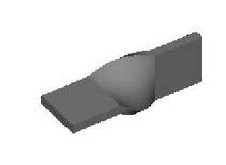

I would like to represent a length of metal 1 inch wide by 3/16 inch thick
that has a 90 degree twist over a 1 inch length.
Following the examples in the documentation (6.5.4.3.7 for twist) I have the
basic shape, but would prefer a less dramatic change from straight to twist.
Can the twist function be changed to start with no rotation, quickly
increase to the desired turns/unit and then back to no rotation?
Stephen

#local fn_A=function{abs(x)-.5};
#local fn_B=function{abs(z)-3/16/2};
#local fn_C=function{abs(y)-.5};
#local N=.25;
#local fn_twistY=function{z*sin(x*2*pi*N) + y*cos(x*2*pi*N)};
#local fn_twistZ=function{z*cos(x*2*pi*N) - y*sin(x*2*pi*N)};
#local fn_twist_Box=function{
   max(
     fn_A(x-.5,y,z),
     fn_B(x,fn_twistY(x,y,z),fn_twistZ(x,y,z)),
     fn_C(x,fn_twistY(x,y,z),fn_twistZ(x,y,z))
#local fn_Box=function{max(fn_A(x,y,z),fn_B(x,y,z),fn_C(x,y,z))};
isosurface {
   function {
      min(fn_Box(x-2,z,y),fn_twist_Box(x-.5,y,z),fn_Box(x,y,z))
   contained_by {box{
     -.5,
     -.5,
     -.5>,
     2.5,
     .5,
     .5>}}
   threshold 0
   accuracy 0.001
   max_gradient 1.294
   max_trace 5
pigment { rgb<.8,.8,.8> }

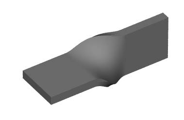

This worked nicely, thank you. A small tweak in the accuracy and
max_gradient and I have this.
Stephen

Nice. You might even want to use this version:
#local smoothfunc = function(x) {x*x*x*(10+x*(6*x-15))}
Which also matches second derivatives, and will make the transition from
straight to curved even more invisible.
 - Slime
