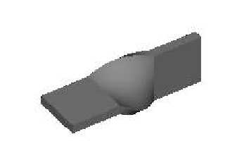

I would like to represent a length of metal 1 inch wide by 3/16 inch thick
that has a 90 degree twist over a 1 inch length.
Following the examples in the documentation (6.5.4.3.7 for twist) I have the
basic shape, but would prefer a less dramatic change from straight to twist.
Can the twist function be changed to start with no rotation, quickly
increase to the desired turns/unit and then back to no rotation?
Stephen

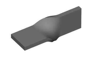

This worked nicely, thank you. A small tweak in the accuracy and
max_gradient and I have this.
Stephen
