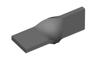

I would like to represent a length of metal 1 inch wide by 3/16 inch thick
that has a 90 degree twist over a 1 inch length.
Following the examples in the documentation (6.5.4.3.7 for twist) I have the
basic shape, but would prefer a less dramatic change from straight to twist.
Can the twist function be changed to start with no rotation, quickly
increase to the desired turns/unit and then back to no rotation?
Stephen
background { color <1.000,1.000,1.000> }
camera {
  location  <    -58.033,     -87.696,      83.175>
  sky       <    0.00000,     0.00000,     1.00000>
  up        <        0.0,         0.0,         1.0>
  right     <    1.33343,         0.0,         0.0>
  angle          2.56896
  look_at   <     -3.480,      -4.962,       4.713>
light_source {
  <0.0, 0.0, 0.0>
  color rgb <1.000, 1.000, 1.000>
  translate  <-65.474138, -85.344511, 105.18157>
#local fn_A=function{abs(x)-.5};
#local fn_B=function{abs(z)-3/16/2};
#local fn_C=function{abs(y)-.5};
#local N=.25;
#local fn_twistY=function{z*sin(x*2*pi*N) + y*cos(x*2*pi*N)};
#local fn_twistZ=function{z*cos(x*2*pi*N) - y*sin(x*2*pi*N)};
#local fn_twist_Box=function{
   max(
     fn_A(x-.5,y,z),
     fn_B(x,fn_twistY(x,y,z),fn_twistZ(x,y,z)),
     fn_C(x,fn_twistY(x,y,z),fn_twistZ(x,y,z))
#local fn_Box=function{max(fn_A(x,y,z),fn_B(x,y,z),fn_C(x,y,z))};
isosurface {
   function {
      min(fn_Box(x-2,z,y),fn_twist_Box(x-.5,y,z),fn_Box(x,y,z))
   contained_by {box{
     -.5,
     -.5,
     -.5>,
     2.5,
     .5,
     .5>}}
   threshold 0
   accuracy 0.001
   max_gradient 1.294
   max_trace 5
pigment { rgb<.8,.8,.8> }
Download 'twist.jpg' (3 KB)
Preview of image 'twist.jpg'

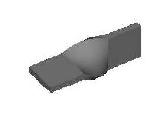

From: Slime
Subject: Re: Isosurface with straight,twist,straight
Date: 5 Mar 2005 23:53:21
Message: <422a8cc1$1@news.povray.org>
Try making this smoothing function (which starts at zero with a slope of
zero, then slopes up, and ends at one with a slope of zero):
#local smoothfunc = function(x) {x*x*(3-2*x)}
And then replace the x in your sin/cos functions with smoothfunc(x).
 - Slime
 [ http://www.slimeland.com/ ]
From: StephenS
Date: 6 Mar 2005 07:29:32
Message: <422af7ac@news.povray.org>
>  - Slime
This worked nicely, thank you. A small tweak in the accuracy and
max_gradient and I have this.
Stephen
Download 'smooth_twist.jpg' (5 KB)
Preview of image 'smooth_twist.jpg'

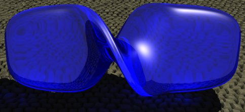

From: Sebastian H
Date: 7 Mar 2005 12:37:52
Message: <422c9170@news.povray.org>
Sebastian H. schrieb:
>> Nice. You might even want to use this version:
>> #local smoothfunc = function(x) {x*x*x*(10+x*(6*x-15))}
>> Which also matches second derivatives, and will make the transition from
>> straight to curved even more invisible.
> Nice, how did you calculate it?
> Once I made some differential equations
> for this problem and solved them.
> It was a bit dirty and some paper sheets got lost.
> If I remember right the differential equations
> for a smooth transition from 0 to 1 were:
> f(0) = 0
> f(1) = 1
> df(0)/dx = 0   # match in first derivative
> df(1)/dx = 0
> d^2f(0)/dx = 0 # match in second derivative
> d^2f(1)/dx = 0
> An approximation method aka Taylor or
> something which could be used to get a match
> in even higher derivatives would be nicer
> but when I got f(x) for the second derivative
> I forgot thinking about it further.
And here is my image from then.
Sebastian
Download 'twist.jpg' (19 KB)
