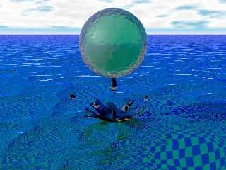

Just doodling, dudes...

That's quite a doodle :)
How did you do the splash?
~Mike

"Mike Raiford" <mra### [at] hotmailcom> wrote in message
news:420b8a2d$1@news.povray.org...
 Thank you.
   Wings, but the main spheres are pov. :) There's one inside the other: the
outer one using Chris' water function, and the inside one is using a bog
standard metallic reflective texture, tinted green.
   Oh, and that checkered plane is 445 units down, to get that effect.
    ~Steve~
> the outer one using Chris' water function, and the inside one is using a
> bog standard metallic reflective texture, tinted green.
Hmm... I would have thought the sphere was transparent, w/ a different
IOR sphere inside .. at least, that's what it looked like.
Wings3D seems to be becoming a mainstay here...
Which brings to me another question. What function did you use for the
water and is it a normal or an isosurface...?
~Mike
news:420b96ab$1@news.povray.org...
> Hmm... I would have thought the sphere was transparent, w/ a different IOR
   I guess I could have duplicated the outer sphere, and then given it its
green tint instead of using a metallic sphere.
  (I'm doing another <better> version right now with a red tint, but it'll
be a couple of hours yet).
   Time is always against me Mike. I find Wings helpful.
   It's a normal function played around with, and increasing the IOR to
1.55:
    sphere {
  <0, 3.7, 0>
  3
   material {
    texture {
      pigment {
        color rgbt <.7, 0.35, 1, 0.4>
      finish {
        ambient 0
        diffuse 0.18
        reflection{ <0, 0.3, .55>
        falloff 5
          fresnel on
        specular 0.2
        roughness 0.003
      normal {
        function {
          f_ridged_mf(x, y, z, 0.1, 3.0, 7, 0.7, 0.7, 2)
        } 0.8
        scale .5
    interior {
      ior 1.55
      ~Steve~
I like wings :) Though I haven't 100% gotten the hang of doing a perfect
model. I've just noticed that a lot of people are using Wings nowadays.
I'm not one of those that insist on doing everything in SDL. You can do
things that would be very difficult w/o a modeller like Wings.
> 1.55:
Ridged Multifractal... I've been playing around w/ that function lately,
and heter_mf and can't seem to get "perfect" results w/o a lot of trial
and error. The water scene I recently did used both, but I'm not happy
with the surface of the water, and still not 100% satisfied w/ the
mountains.
~Mike
