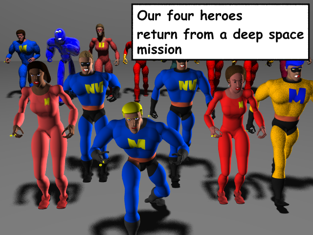

Please find enclosed two images.  One is a 640x480 AA 0.3 rendering of an

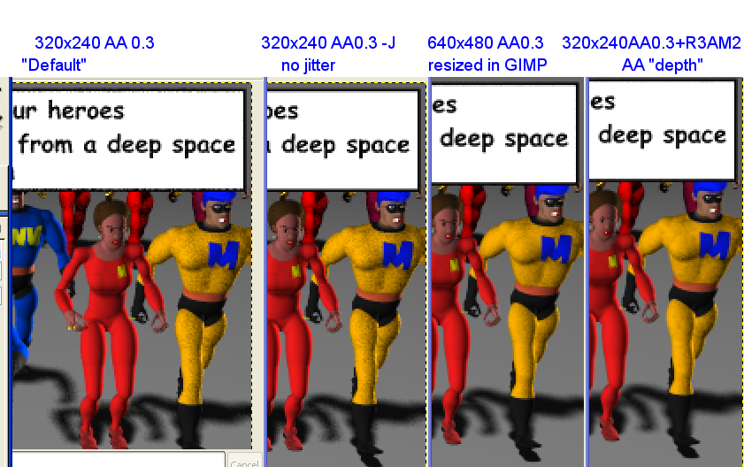

image.   The other are a series of images which are currently 320x240 in
size but were viewed in GIMP at 200%-- you're looking at a screen grab of
several open images lined up next to each other.
My goal is to have "captions" look crisp and neat which have been generated
in povray. Among the benefits of captioning images in povray are:
i) stubborn tradition/ too lazy to use other software
ii) it's animatable
iii) adding text to images in GIMP and CorelPhotoPaint is a royal PITA,
whereas it's perfectly controllable in pov, regardless of message length.
Left to right in the composite image, they are:
1) 320x240 AA 0.3.  The original image, the way I had been doing things
before. There is a rattiness to the box which detracts from the
professionalness of the product.
2) 320x240 AA 0.3 -J.  Anti-alias jittering turned off.  The problems with
the box have gone away, but I believe it detracted from the quality of the
images, especially in showing of round edges. (Yeah, this image here seems
to make me a liar, but I started this when I saw a jagged edge on another
field of view.) The bumpy texture of the guy's yellow shirt looks off, and
I'm guessing this would be sloppy in animation.
3)  640x480 AA0.3, then resized in GIMP.  The text box looks great, and the
characters aren't hurting.  The nusiance of this approach is of course that
it requires an image resizing.
4) 320x240 AA 0.3 +R3 +AM2, increased AA depth with antialias method 2. Text
box is great, but we've "erased" the poor lady's eyebrows!!
Any advice here?
A) Has anyone explored with the +R and +AM parms-- did you find erased
eyebrows, too-- any cliffs or good things to try?  I'm wondering if there's
a way to turn of the "intelligence" of the supersampling. In thinking how
the resizing of 640 pixels turned out great, I'm wondering if pov's AA  were
being too intelligent for me.
Although turning off jittering slightly decreases the quality of a still
image (since randomness is good for our eyes), it will *increase* the
quality of an animation. Ever seen an animation of a checkered plane? Look
at the horizon: even if the camera is still, if anti-alias jittering is on,
it will look like static. This is because the random jittering changes from
frame to frame. So, if animation is what you're heading towards, try it in
an animation before you write it off as a bad idea.
Besides, the guy's shirt looks almost exactly the same to me in the first
two images.
the
that
Except for color clipping (which is irrelevant in a scene without very
bright objects), this is equivalent to 320x240 with +A0.3 +R6. (The default
is +R3, +R6 is like that, four times, averaging the result - which is just
what you did in GIMP.)
Text
+AM2 starts by sampling the *corners* of pixels instead of the centers.
Probably her eyebrows pass through the center of pixels but not the corners,
so they're missed. This is a common problem (happens a lot with ropes or
other thin objects in the distance) that happens with *both* AA methods, and
has no good solution at this time.
> Any advice here?
Based on what you were happy with and on my experience, I'd suggest going
with +A0.3 -J and something between +R3 to +R6.
> corners, so they're missed. This is a common problem (happens a lot with
> ropes or other thin objects in the distance) that happens with *both* AA
> methods, and has no good solution at this time.
and the
course that
default
is just
	Not exactly, since the "0.3" in "+A0.3" means that pov will stop
supersampling before having sent all the rays if it doesn't make too
much difference.
	Greg, In answer to your question I would go with +A0.2 +AM2 +R4 and
try lowering the "0.2" if it doesn't work.
	What would be nice is an option to force a *minimum* level of
supersampling to occur before taking the threshold into account. This
would be equivalent to rendering at higher resolution with lower AA
settings then resizing, without needing the "resize" step...
		Jerome
> Cone tracing.
Er, I meant, that is currently implemented in POV-Ray. =)
> > Personally, I think it would be more convenient to have an object
property
> > that forces *higher* AA (more subsamples) for the current pixel when
it's
> > intersected. This could be used to solve the eyebrow issue.
> Which, unfortunately, doesn't help with small objects, since the problem
> is that the ray never intersects them...
The idea is that the flagged object wouldn't be drawn, it would only be
noticed, causing higher AA. Then you could manually surround tiny objects
with larger, flagged objects, to cause higher AA in the vicinity of the tiny
objects. (For instance, a thin cylinder rope could be surrounded by a thick
cylinder with the flag.)
 - Slime
 [ http://www.slimeland.com/ ]
From: Slime
Subject: Re: Ratty text, further explored, with superfluous big images
Date: 7 Jan 2005 17:22:51
Message: <41df0bbb$1@news.povray.org>
> much difference.
Good point; my suggestion will be a little slower then.
+R4 is *really high* for +AM2. See the picture at
http://www.povray.org/documentation/view/3.6.1/223/ (towards the end). +R2
should almost always be sufficient when used with +AM2.

From: "Jérôme M. Berger"
Date: 8 Jan 2005 04:34:29
Message: <41dfa925@news.povray.org>
Hash: SHA1
end). +R2
	Yes, sorry for the typo, I usually use +R2 too.
		Jerome
