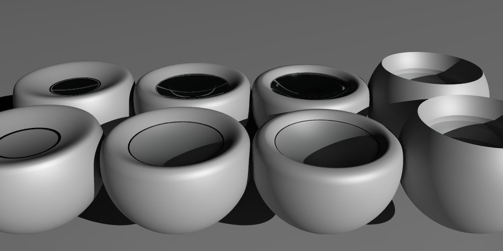

For my PovComp WIP, I'm trying to use blobs as liquid containers. I have
made a little scene to illustrate the problem I have.
In this scene you see eight containers, on the right are two CSG
containers to check if the problem appears. On the left you have 3
series of blob container from deep on the right to shallow on the left.
They are all filled with liquid, first plane, the containers are filled
with a semi sphere that is a little bigger than the hole (which is what
I would like to do) and second plane, the liquid is 'differenced' to be
a little bit smaller than the hole.
As you can see all the first plane blob containers have a line appearing
at the contact between the liquid's surface and the container. And this
line gets thicker as the slope is less steep.
Is this a bug ? Is it something I made wrong (I made the code available)
? Is there any way to avoid it ?
Thanks for your help,
JC

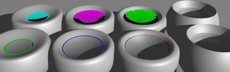

You've been hit by a bad case of
ray-misses-the-intersection-between-two-surfaces-and-hit-what's-behind!
Adding a different interior_textures to each examples give me 6
differently coloured areas where you have black.
My render (raised the camera a bit, no radiosity, interior with ambient 1):
Download 'essai_fringe.png' (86 KB)
Preview of image 'essai_fringe.png'

Any hope I can lower these artifact (increasing precision ??) ?
At least you provided me with some kind of work around, I'll color the
interior with something harder to see than black.
POVComp computer is mine !!!  ;-))
>>> filled with a semi sphere that is a little bigger than the hole
>>> (which is what I would like to do) and second plane, the liquid is
>>> 'differenced' to be a little bit smaller than the hole.
>>> appearing at the contact between the liquid's surface and the
>>> container. And this line gets thicker as the slope is less steep.
>>> available) ? Is there any way to avoid it ?
>>> JC
>> ambient 1):
>> Alain
Sory for the late reply: compoter corruption :(
You need to use a texture in each object and follow it with an
interior_texture. You can remove the default{} block completely. It
seems impossible to add interior_texture in the default block.
Sample code:
union {
object { BBassin (0.4, 1.2) texture {
pigment {rgb 1}
#if (Radiosity)
finish {
ambient 0.0
diffuse 0.6
specular 0.3
#else
finish {
ambient 0.1
diffuse 0.6
specular 0.3
#end
interior_texture{pigment{rgb<1,0,0>}finish{ambient 1}}
difference { object { Water } object { BBassin (0.39,1.2) } material {
M_Water } }
translate <-3*e,0,e>
>>> ambient 1):
>>> Alain
> Sample code:
> union {
> pigment {rgb 1}
> #if (Radiosity)
> finish {
> ambient 0.0
> diffuse 0.6
> specular 0.3
> #else
> finish {
> ambient 0.1
> diffuse 0.6
> specular 0.3
> #end
> M_Water } }
> Alain
